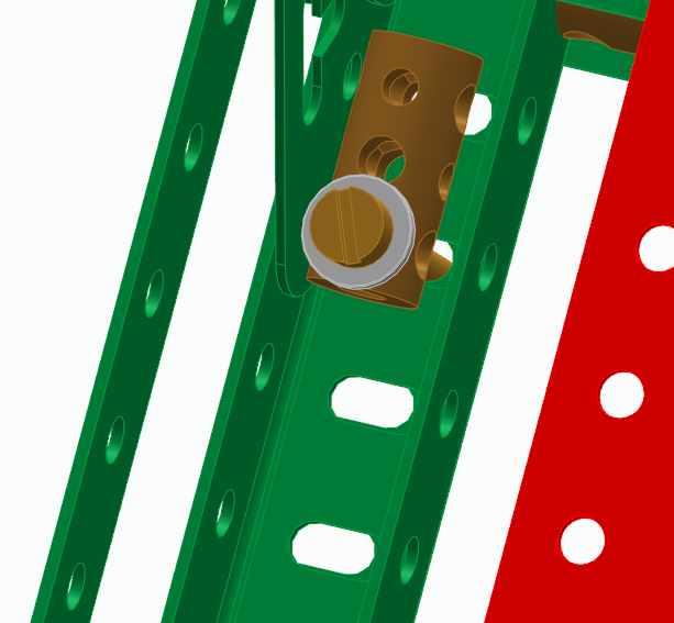

I have imported the parts from SW. They are all Meccano parts, so loads of slotted holes. I haven’t re-added dimensions to most of them.

Slots if created as Slot features will have an axis in the middle, so an Axial Align or Connect can be used to say place a bolt in the center of the slot. If the geometry just looks like a slot because it was imported or created with the standard Extrude command, then that axis will not exist, and you will have to use another method. You can place a Sketch in the part and draw a point in the center of the pseudo slot and it will replicate an axis as a workaround.

I was stuck on the idea of a slot mate. I also was thinking of making the axis of a transverse hole in a cylinder perpendicular to a surface.
On the slot mate. Is it possible to offset the axes of the hole and one of the slot’s radii? Then I could use a range value equal to the length of the slot side. Coupled with a tangent mate this would give me the equivalent of an SW slot mate.

On the slot, yes you can offset the axis, but you will need to use the Parallel relationship for that.

A clumsy way could be using connect with range function.
The bad thing that it will not follow if you change the slot length.

Here is a example with along path. Bad thing is the need of a sketch but it will follow slot changes ..
