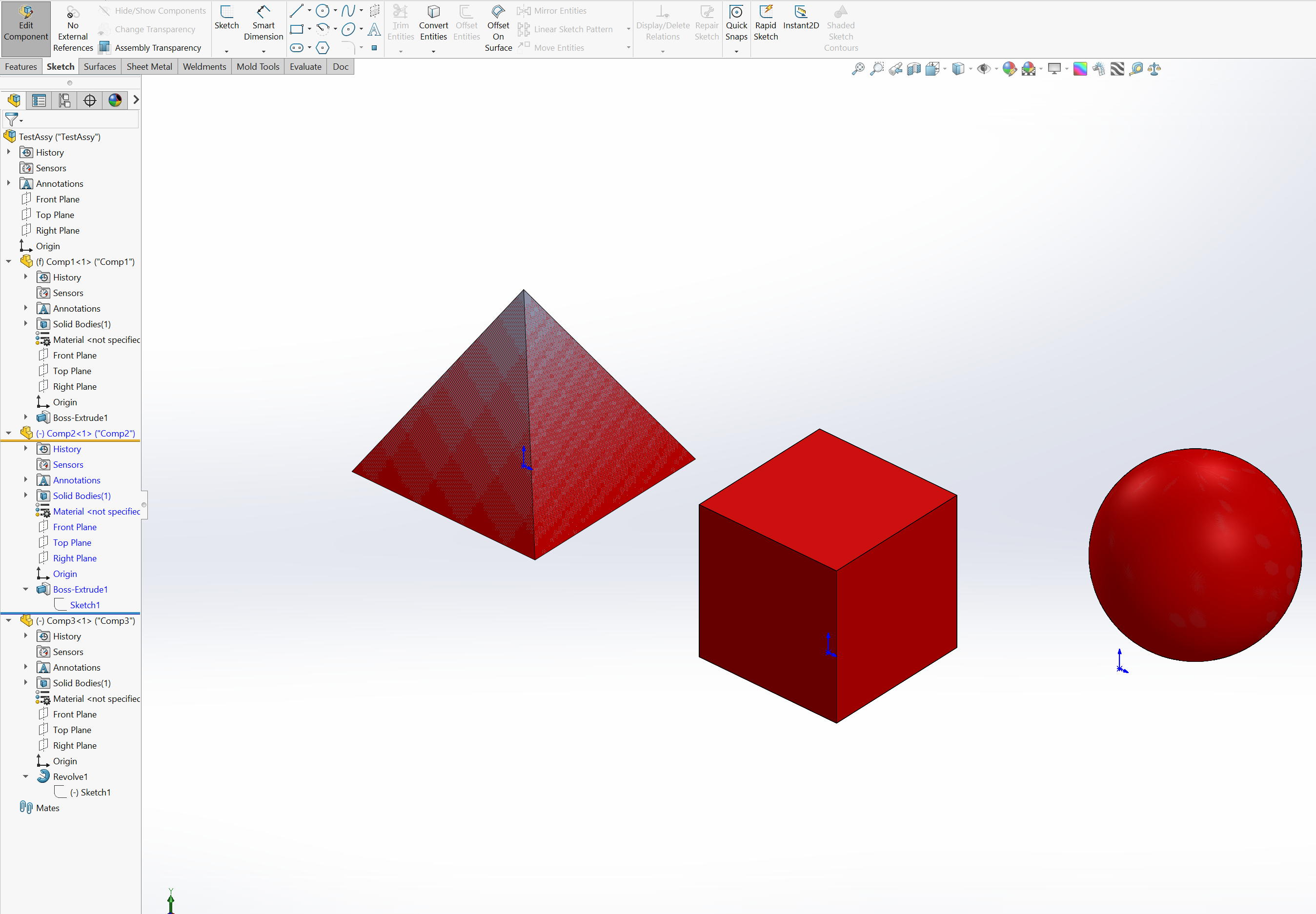

I created a sample assembly and a macro for testing these things. Attaching to this post. It is an assembly with 3 components. First has it’s origin matching the assembly origin, while the other 2 are moved. The third one also has the body away from the origin.

Notice that when temporary bodies are created, they have to be moved in order to appear in correct positions (overlap the original bodies). Running this macro should give this:
However, if you comment out “MoveBody component, tempBody”, then the temporary bodies end up at the assembly/first component origin:
This seems to imply that they are created using assembly coordinate system - meaning, the assembly is the container.
However, if you change “DisplayBodies comp1, tempBodies” to “DisplayBodies comp2, tempBodies”, meaning that the graphics are hosted by the component that has a different origin, you get this:
It almost feels as if temporary bodies really do not exist until you call Display3 on them, which truly creates them in the model space, using the coordinates of whatever component you passed into Display3. However, applying transform prior to calling Display3 still moves them, which implies the opposite - they do exist somewhere.
Also, if after running this macro, you open Comp1 (which was passed to Display3), the temporary bodies are not visible there. Which implies that temporary body graphics are still hosted by the assembly..? This is really strange.
