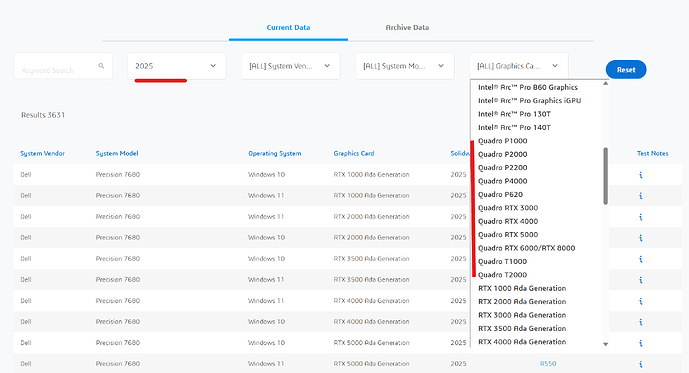

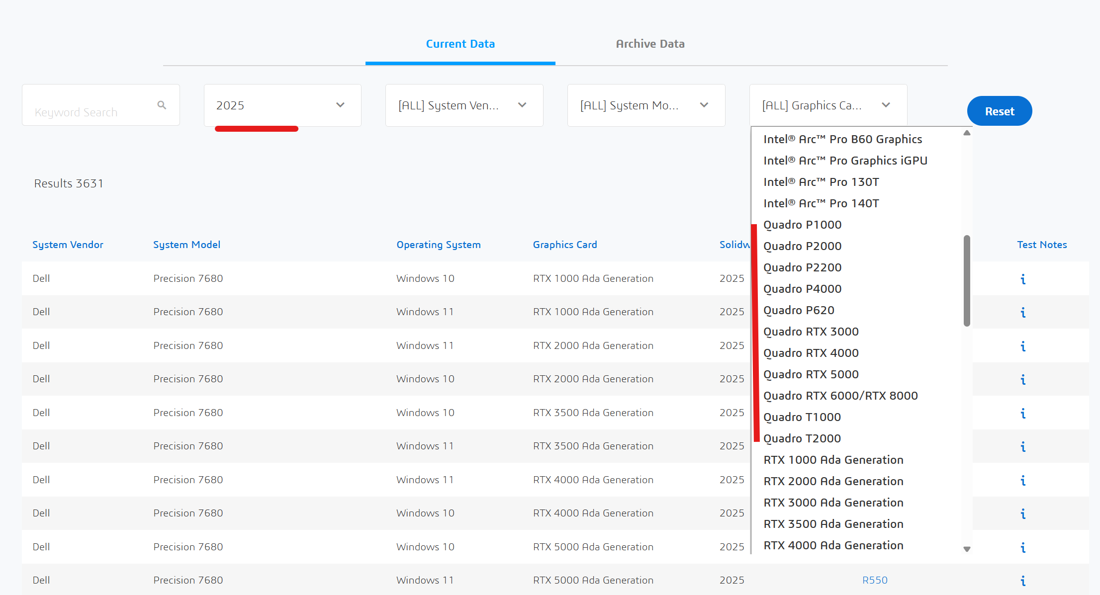

We are dangerously close to upgrading from SW2017 to SW2025. Our workstation are a little old, and are equipped with Quadro K5000 video cards. The latest Nvidia driver is the 475.14 version. Is anyone out there running this card and/or driver with SOLIDWORKS 2025?
only Quadro cards supported for SW2025
here’s the link to SW: https://www.solidworks.com/support/hardware-certification/
Certified and supported are two different things. On the same page where you grabbed your image, you will see this:
The Quadro K5000 appears on that list. I’m looking for anyone actually using the card with SW2025 to see if there are any quirks/gotchas.
