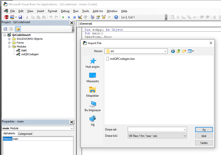

I added a module to create a qr code, but if you need to add it too, I’m adding it here.
VbQRCodegen-master.zip (17.6 KB)
https://github.com/wqweto/VbQRCodegen

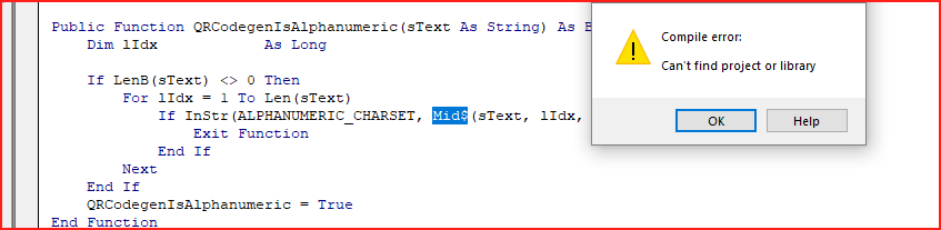

I get this error when I run it:
Had the same error. You have to de-select the missing reference, see my post above.
Thanks Frank, didn’t think it was the same error.
After clearing it, it works like a charm. Here’s the macro with the missing reference removed for those who don’t know how to remove it.

I get the following error whenever I run the modified version shared by Alex:
This happens after I type something in the box and select “generate QR Code”
I am using SW 2022 SP4 on Windows 10
In the VBA editor, go to ‘Tools-> References’. There is probably a broken reference that either needs to be unchecked, or more likely pointed to the correct dll.
This link has a more thorough explanation.
https://kb.blackbaud.com/knowledgebase/Article/75344
