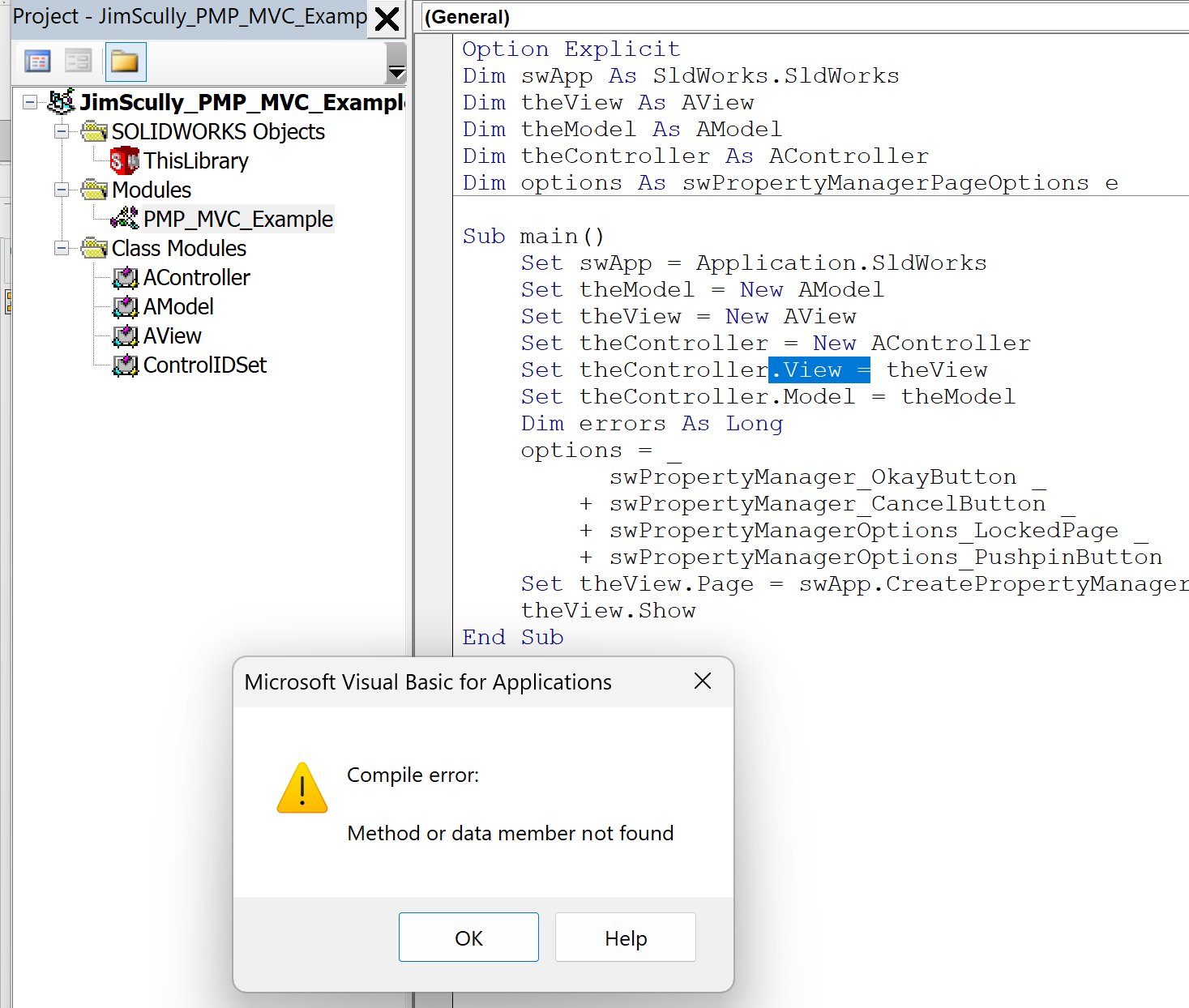

Jim, I made a project out of the modules you shared, but get the following error:
“Method or data member not found” for “theController.View”.
I see a property named “Model” is defined in “aController”, but “View” seems to be undefined.
I attached my SWP file below.
Thank You
JimScully_PMP_MVC_Example.swp (63 KB)
Gah. I made some last minute edits. You can delete the
Set theController.View = theView
line. The controller doesn’t reference the view at all, so it doesn’t need to know about it.
