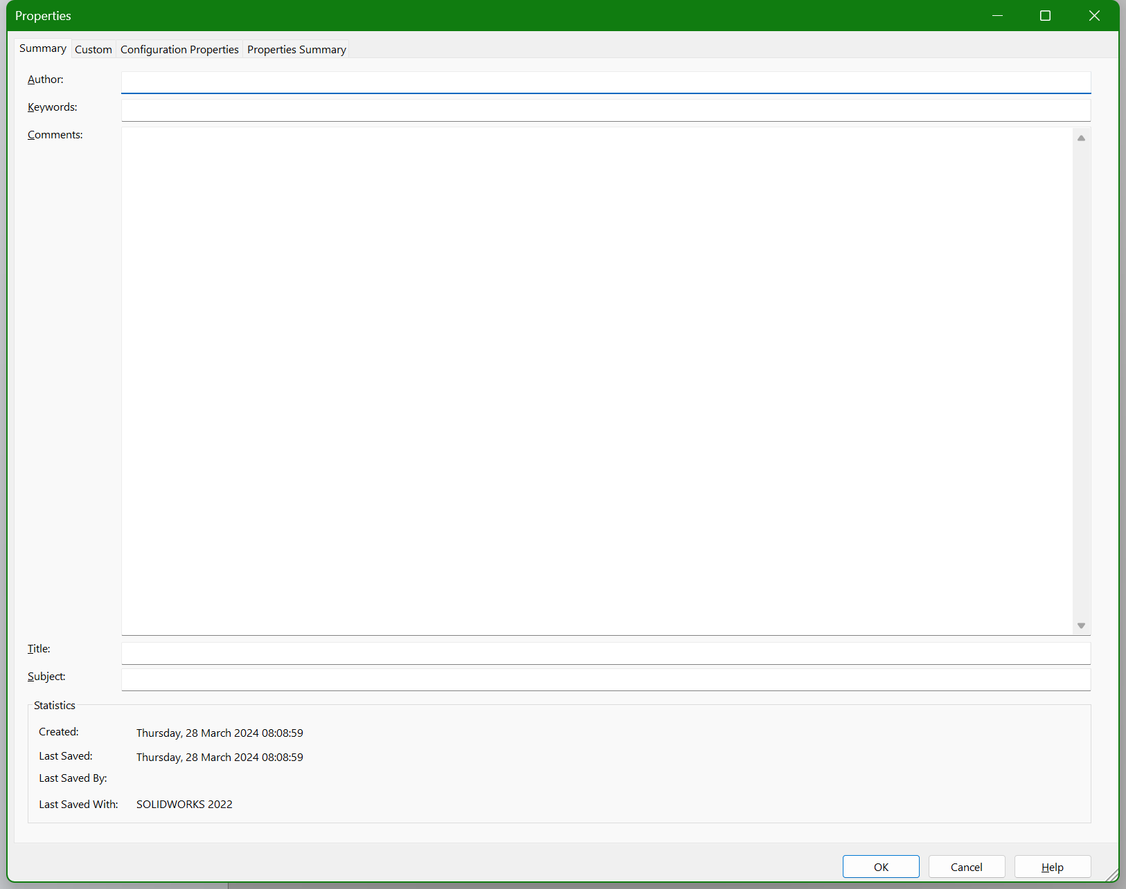

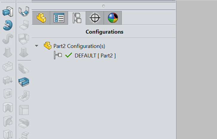

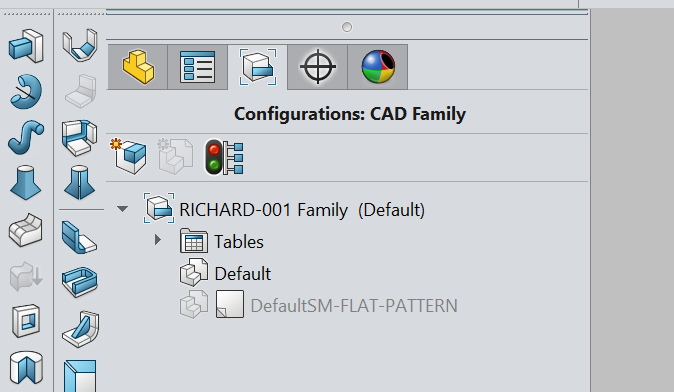

I have certain files that i open that have the two very basic first tabs missing int he file properties dialog. The “Summary” and “Custom” tabs go missing and the “ConfigurationManager” tab in the FeatureManagerTree changes to a “CADFamily” icon and is totally different then normal and yet i never changed anything in the files to initial any change in this regard, I literally open an old file and it its like this.
The straw that made me post is i opened a SW2001 file and its missing the tabs as i wanted to check file creation/modified dates before updating it only to have them missing, its like wtf.
Screenshots attached showing areas for explanation. I cant find anything to change it back to normal and i don’t know whats causing it to change as other files open as normal.

I found some workaround, but I am not familiar with 3d experience or solidworks connected so I could misunderstanding the issue.
Workaround: Open the part in SOLIDWORKS Desktop, remove the Rebuild on Save Mark and Display Data Mark from all configurations and save. Then re-open the part in SOLIDWORKS Connected.
Another kb was about lightweight assemblies and the need to put them in resolved mode.

This is just with classic normal SolidWorks. No connected or 3D.Bad.Experience crap. I just open certain files and they are missing these tabs whilst others of the the same vintage open and display the tabs as expected.
