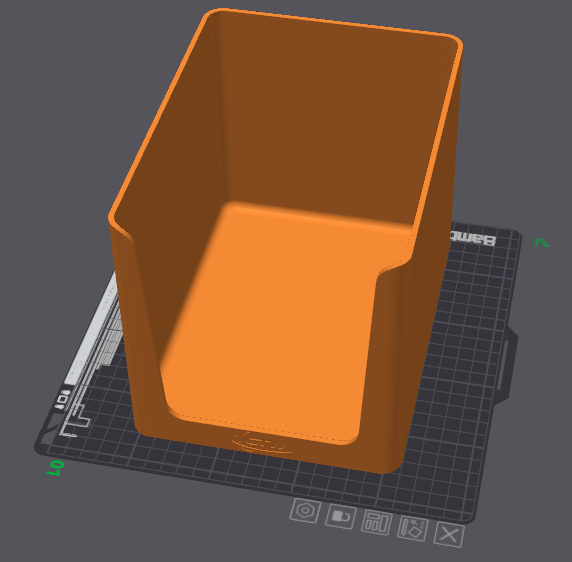

If you like printing big flat things, I recommend cutting down a piece of glass/mirror and glue some steel to the back of it. I printed these (picture below) to hold K-Cups for the break room, and you can see it fills up most of the bed. If you print that on a flexible build plate, the stresses can cause the perimeter to lift. It stays stuck to the build plate, but the build plate flexes up off of the bed. With the glass build plate, you eliminate the flexing problem. It might still lift around the perimeter, but that’s a different issue.

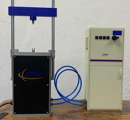

The first machine I bought didn’t come with the AMS. (The filament mixer box.) I didn’t think I needed it, but the 2nd printer I bought I went ahead and ordered it. After about 1 week I ordered the AMS for the first printer. Multicolor printing has it’s place, but it isn’t something I do much of. (The photo below is of a 1/4 scale mockup of one of our machines.) The downside to multicolor printing is it uses a lot of filament for every color / layer change. The same is true for me regarding support material. I’ve designed parts to print without needing support for so long that I don’t bother. What I didn’t account for, is how nice it is to have two spools of the same color in the machine. No more throwing away partial spools because you don’t think there is enough filament left to be useful. No more running out of filament mid print. I am now a convert.
