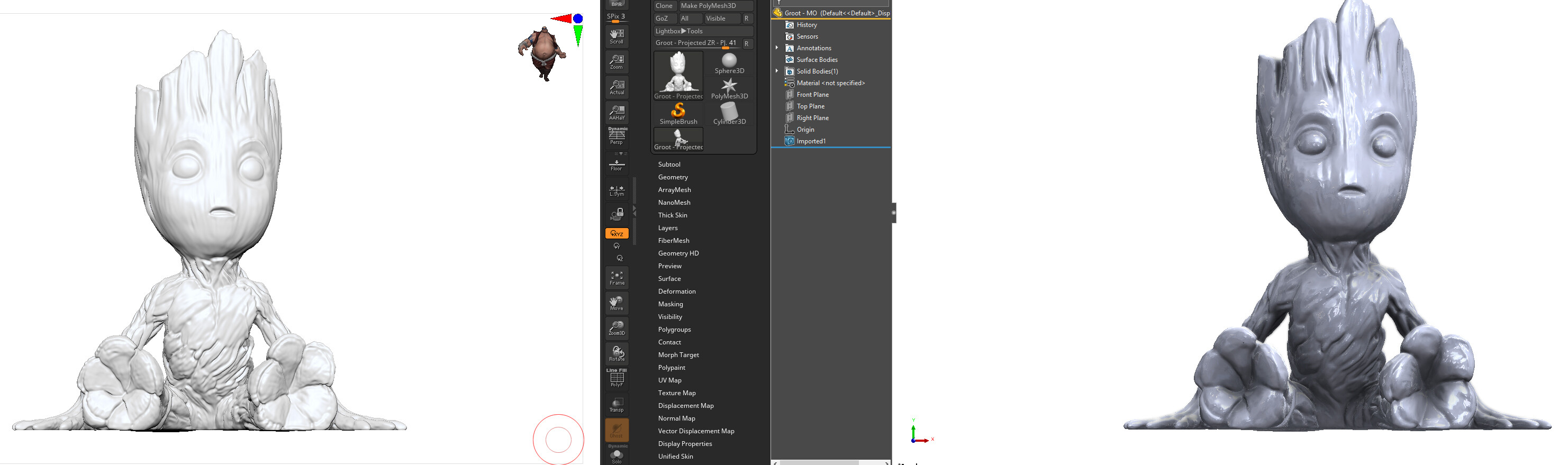

@Paul: Here’s a side by side of everyone favorite kick azz Tree…Groot!!! This was downloaded from an online website as an (.stl), which I then opened in zBrush did some clean up and remeshing a bit, imported into SW with Power Surfacing and as you can see…very little detail loss. Attached is the paraolid file.
Groot - MO.x_t (48.9 MB)
Power Surfacing is a great add-in if working with meshes is something that you work with quite a bit but I’ll also add that having zBrush in this workflow helps to streamline things 10 fold!!!
