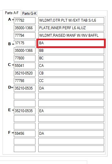

Is it possible to search the PDM database, to populate an Edit Box on the data card based on the part number in a separate edit box?
These values are placed on a 2D drawing. We do not create assemblies of these configurations or place part views on these drawings, so not able to use link to properties. Trying to avoid having to manually look up these parts, to copy/paste the description.

Out of the box, I can’t think of a good way to do this. However, there are a lot of possibilities with a custom PDM Add-In. You could create the logic in the add-in code and add a button to the card that the user can click to “refresh from database” to trigger it or even make it automatic during check-in or transition.

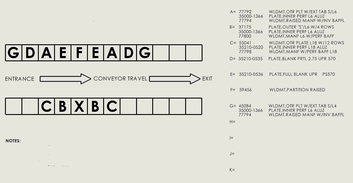

There are numerous combinations of these parts that can be used in a particular position. It’s easy enough to type in a part number and would like to populate the part’s Description. All of the info populates the data card for easy view and the drawing which can be printed out + a sticker to place on the unit. At the moment we will have to copy/paste part numbers and part descriptions. Would like to add a little “smartness” to the process, since we don’t create 3D assemblies.

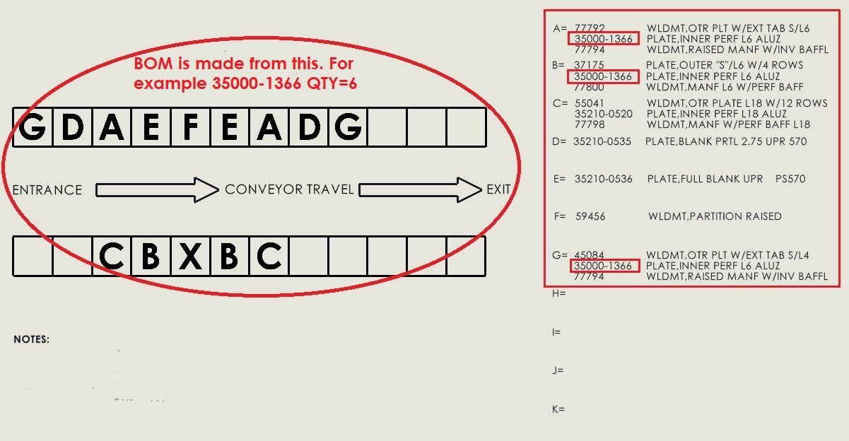

The “letter positions” are not kits. All of the parts listed are loose parts and have real models, I just wanted a way to grab metadata of the part number listed. There is only one final BOM, consisting of the parts listed and how many positions it’s used. For example, 35000-1366 has q total qty of (6).
