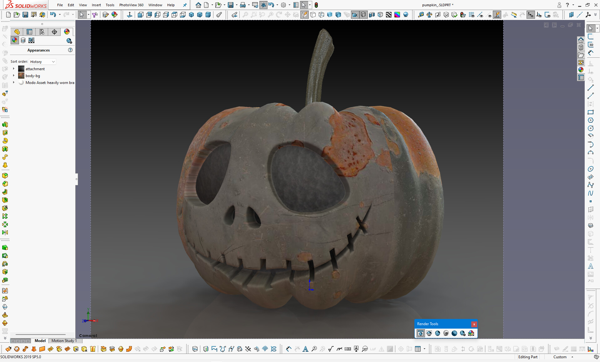

…pumpkin render spirit for the holiday…
Andy: can you please give a short “PW360 for dummies” on the basics of how you get such a crisp render, I’ve tried many times, but mostly ending up with a JPG image save from a “saveAs”.
I find 316 stainless steel especially difficult, as it gets more colored than a shiny mirrored surface. I even think if I use mirror glass as substitute it look better than stainless steel.
