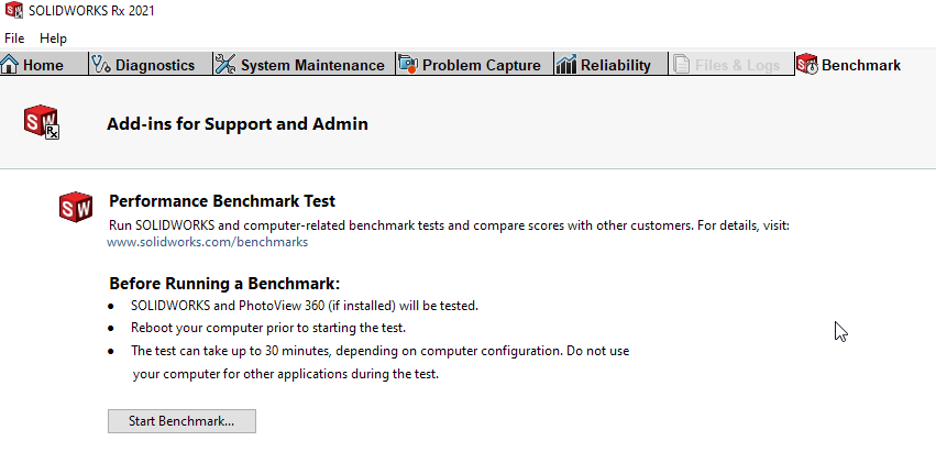

There’s built in performance testing in Solidworks Rx on the benchmark tab that does exactly this.
I’m aware of that. I want to specifically use our models and use operations that we do/use most often. Not only do I want to use it to compare machine performances but I also want to use it to test “Modeling practices” and effect on performance.
