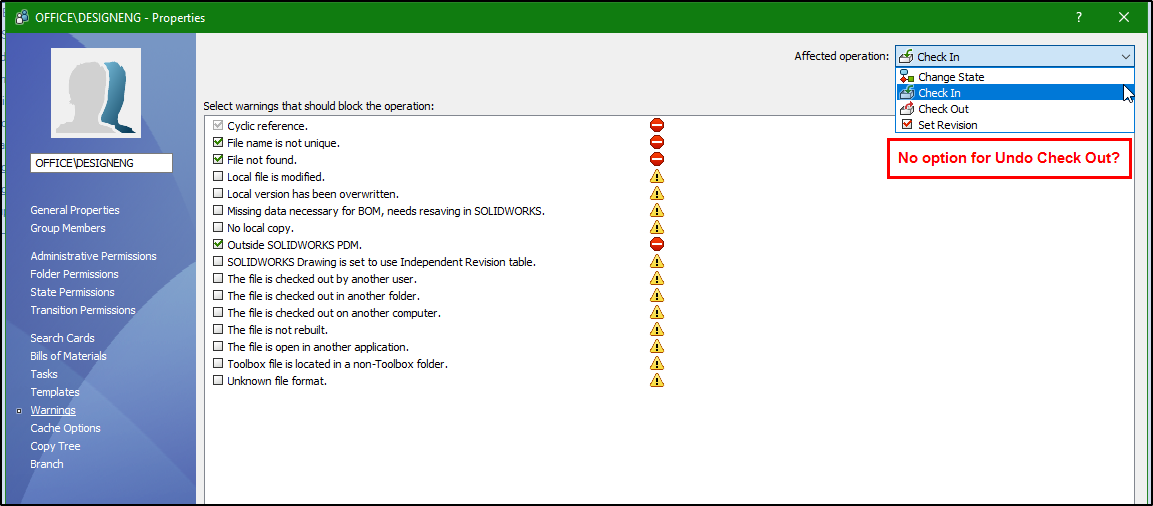

PDM, User/Group Properties -> Warnings ->Check In check boxes apply to Undo Checkout as well? Why?

I go to Undo Checkout and it’s blocked due to the File not Found I set to block. I thought, these should just be warnings in the undo checkout, not blocking, why did I do that? So I go in Admin tool to fix so I can Undo Checkout with the warnings. Nope, there’s not one for undo checkout, it uses the same as Check In. WTH? Undo Check Out inherently means I don’t want to make changes, so how am I supposed to get them checked back in when these files are on someone else’s PC?
Am I missing something here? Anyone have work around for this?
The quick solution would be to have the Admin undo the check-out, assuming the admin doesn’t have as restrictive warnings blocking the check-in/out actions. I’m not sure why it uses the same permissions as Check-In, but there’s a lot I don’t understand about why the developers went with the current architecture of PDM.
Only option, as mentioned by AlexB, is to allow an admin or certain power users to do it.

This came up in yesterday’s PDM SWUG meeting. Tor posted the SPR number for the existing Enhancement:
Enhancement SPR 879147 “Enhancement: Add ‘Undo check out’ as a separate command while setting ‘Warnings’ for users/groups in EPDM administration.”
