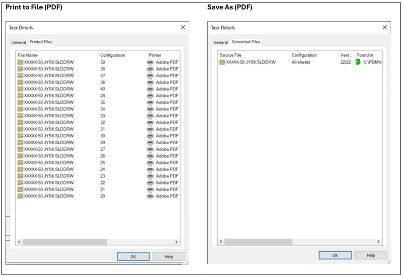

I am trying to modify the PDM Task macro to print in PDF instead of a phisical printer as the export to PDF function (basically save as → pdf) is bugged and the output pdf differs from what you see on screen. The PDF printer works perfectly from SW interface (File → Print), but if it run from the macro there are some files in my sample data that often cannot be correctly exported: often they end up as a minuscule drawing in a corner of the paper, like the pdf creation was aborted midway before fitting drawing to the paper size; sometimes the drawing borders are fitted and only the text and some lines remain small in a corner of the “paper space”.
