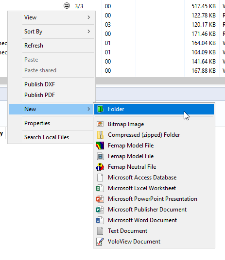

Interesting. Virtual Docs sound like just a blank file. There must be a setting somewhere that prevents them?
Edit: using 2019 SP4, help for that version shows same process to make new one as 2022. System Admin has the option to create.
I believe it’s tied to permissions. Try as full blown admin just to see if it shows up.
The option shows up if I log into another system with my username. Does not show up on my vault view if I log in as another user, not even for system admin. I suppose somethings corrupt with the vault view on my machine…
