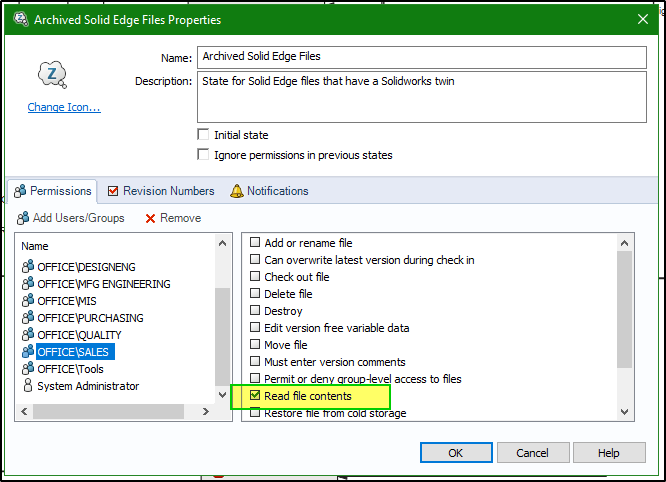

I don’t remember what exactly I was doing when I discovered that it’s possible to have certain states that users can see and others that they cannot by toggling the “Read File Contents” permission.
If at least one state gives them permission to “Read File Contents” then they can see the file in the system, but when they look at the version history, all the versions that they don’t have permission for will be greyed out. I honestly don’t know if this helps your use case at all but it was an interesting discovery that could potentially be used to control viewing permission in a similar manner.

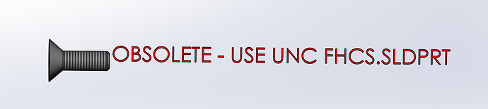

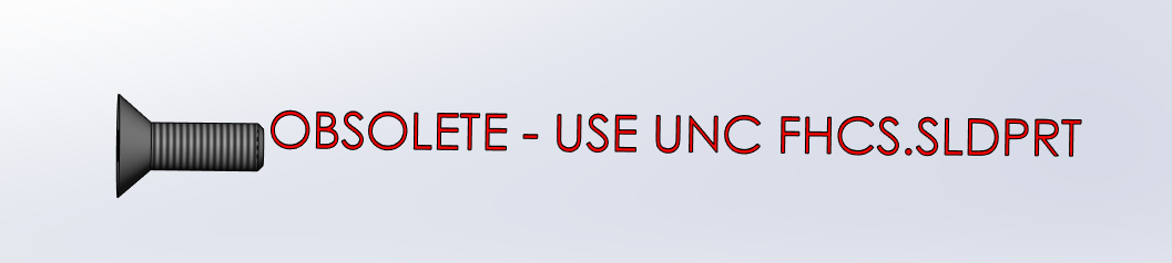

One option is to alter the SE files so that it is blatantly obvious to anyone opening it that it is not to be used. Before implementing PDM, we had some duplication of hardware items where the file names were different. For example, we have 2 configured flat head cap screw models, one for coarse threads (UNC FHCS.SLDPRT) and another for fine threads (UNF FHCS.SLDPRT). At some point someone made a third model with coarse thread dimensions and just called it FHCS.SLDPRT. It snuck its way into a bunch of assembly models. I’m not wasting my time correcting all those assemblies. I just add a feature to the rogue model so that it is obviously the wrong item and points the user to the correct item:
When people open this part, or assemblies with this part, they immediately see the issue.

I like the anecdote about adding strange feature to wrong model to make it obviously wrong. Before PDM we would just move the file, intentionally breaking the file ref; forcing the user to update. This was usually only done with old revision that should have already had all it’s where used updated per normal process.
