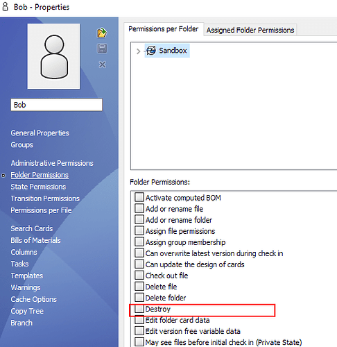

Its standard Windows function for bypassing the recycle bin…in the vault you must have Destroy permission though.

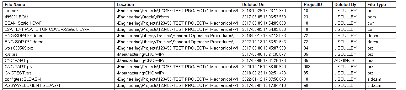

The report generator can help you out as well. Here’s a report that lists all deleted files, sorted by file extension.
@[ListDeleted]
§Name [All deleted files sorted by file type]
§Company [CADForum]
§Description
[This query will list all deleted files, sorted by file extension.]
§Version [1.1]
§Arguments
§Sql
select Docs.Filename as 'File Name',Projects.Path as Location,Hist.Time as 'Deleted On',Hist.ProjectID,Users.FullName as 'Deleted By',
lower(right(Docs.FileName, charindex('.', reverse(Docs.Filename) + '.') - 1)) as 'File Type'
from dbo.Documents as Docs
inner join dbo.HistoryDelete as Hist on docs.DocumentID = Hist.DocumentID
inner join dbo.Users as Users on Hist.UserID = Users.UserID
inner join dbo.Projects as Projects on Hist.ProjectID = Projects.ProjectID
where Docs.Deleted = 1 order by 'File Type'
Gives you something like this:
