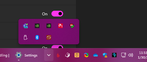

The PDM Icon no longer appears in the taskbar notification area (windows 11.) Without that, I can’t log out and switch to the admin account. It is not hidden, I have all icons showing. It is just not there anymore. Any ideas on how to get it back?
Right click taskbar and choose “Taskbar Settings”. Browse down to “Other system tray icons” and make sure that either “Hidden icon menu” is turned on or that “Solidworks PDM” is turned on.

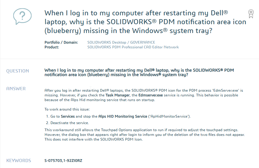

This could also help KB QA00000122248
I don’t see a service by that name.
