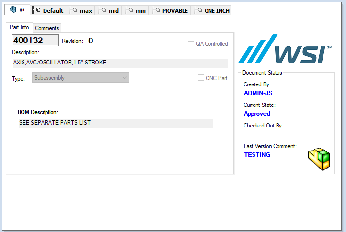

Yes. The blank tab will be shown unless you are a member of the group named on some other tab. Normally, my card looks like this:
If I’m logged in as a member of the ‘Vault Admins’ group, it looks like this:
The ‘Admin Info’ panel on the bottom contains any fields I might want to tweak manually.
