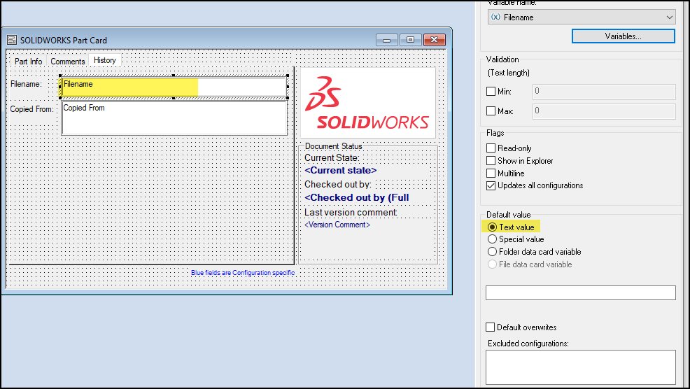

I think you’re on the right path, san resorting to the API. You will have to store the “Filename” on the data card, meaning you need to set your legacy data, maybe with “Modify\Update values in files”.

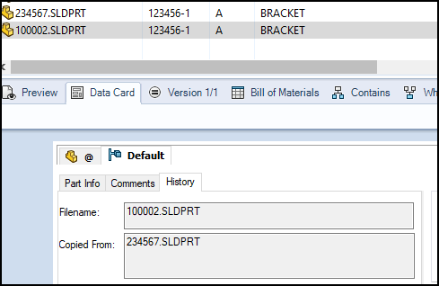

Once set, when you copy the file, the new file’s data card will have the original filename. Don’t set defaults, you want it to keep the original file’s name.

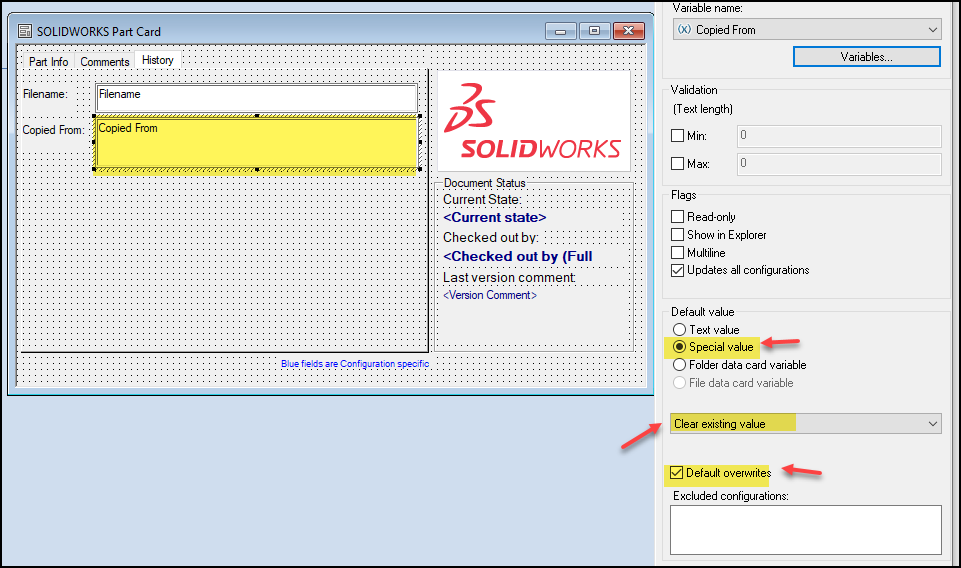

Then add a “Copied from” variable, set its default to clear.

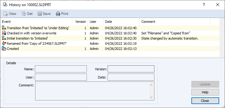

Have an “Initiated” state in your workflow for new files with the transition.
Create a “Set Variable” action, first to copy the filename, then to set the filename. I set “Overwrite Latest Version” so I wouldn’t create another version but if you have other variables with SolidWorks mapping, you can’t use it.
Like you said, it your users can rename files, you may need to set filename at other parts of the workflow. Maybe not all of them but certainly “Release”. We don’t allow renaming once it leaves WIP except by an admin to correct a mistake.

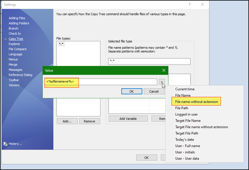

It stinks that there’s no option for %filenamewe% in set variable transition action. I know there’s a file name without extension in other place(s), maybe branch/copytree user settings? Some consistency would be so much nicer.
Am I missing something? I don’t see an option for filename without extension. It’s not a show stopper, but certainly don’t need the extension in this case, it’s obvious it was copied from the same type.
Had to go look. It’s the copy tree/branch user/group settings that offers %filenamewe% notice they snuck the ‘s’ in there for source I assume. Confession, due to some ID10T error in the workflow transition actions we might have a few files that have the filename value set to “%filenamewe%”
