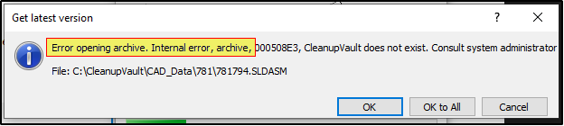

Has anyone dealt with corrupt archive folders in the archive server? I am seeing this only on the hex-decimal of doc id named folders (contains thumbs and versions of ONE vault file). The 0 - F folders are all fine.
Trying to browse into the folder on archive server gives typical windows corrupt directory error.
I’m at a bit of a loss and searches have all just lead to physical media errors. The archive server is a VM so disc corruption could be possible, but would be identified by the hypervisor. From what I can understand the failed media would be detected by some layer between physical media and the “drive” on the VM. That is out of my domain as IT manages the storage and VM farm. I just have two servers out of dozens on the stack.
