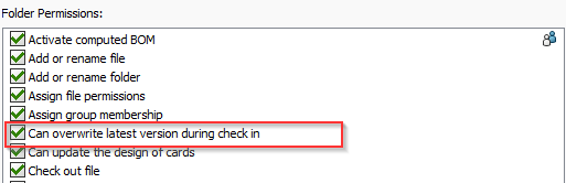

You’ll have to check and make sure you have permissions in PDM to do so. Can you verify this settings is checked for your PDM account via the admin tool?
Additionally, you are using the arguments in the incorrect order. You’ve passed 64 in as the window handle, not the flag argument.
