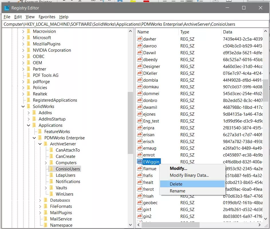

I found a VAR blog suggesting editing the user login name from SQL. https://www.goengineer.com/blog/editing-users-solidworks-pdm#:~:text=To%20make%20changes%20to%20the,that%20needs%20to%20be%20updated. Tempting to do that. But I read farther and wondered, well, should I change the name in the registry too or just change in database table and assume something triggers to update the registry?

Thank you. I don’t know if it should even be a concern. In the link below they go on to talk about removing a login name from the registry on the archive server. You make it sound like that is cache that is loaded/refreshed automatically. I guess if old logins are not automatically flushed from that registry and there is a conflict then there is a need to manually remove that old login from registry?
This image from the linked page is what I was talking about:
I don’t have any users except “admin” there. Our PDM is linked to our old AD username and password. Since we’ve gone to Azure AD, I’m now in the process of going to PDM only logins. This requires that I rename the username in the “Users” table to a new name, then we set a password for each user. This does create a new user registry entry similar to what you show but its down under "Vaults<Vaultname>\ConisioUsers
The registry saves both AD and PDM users, name for both and hashed passwords for the latter.

There are two places in the archive server registry where PDM stores the login information for vaults on the server. This is because the Login type can be set to use the setting from the server or set to override the server settings to use different settings on a specific vault. Using vault level settings will allow you to do things such as have different users who use the same user name with different passwords for different vaults. These would be stored separately for each vault.
Server level location: HKEY_LOCAL_MACHINE\SOFTWARE\SolidWorks\Applications\PDMWorks Enterprise\ArchiveServer
Vault level location: HKEY_LOCAL_MACHINE\SOFTWARE\SolidWorks\Applications\PDMWorks Enterprise\ArchiveServer\Vaults<vaultname>\
PDM logins are in ConisioUsers
Windows users and groups defined in the login Settings dialog are in WinUsers
Users that are deleted in the vault are not removed from the archive server registry. This is because it is possible to recover a deleted user account and the registry is storing the user password.
The user name is just a string so it should technically be possible to update the string since the system is going to use the UserID internally to identify the user. For PDM logins, you would also need to change the registry key name for the user so that the system can authenticate the password.
