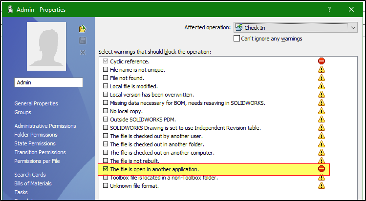

Maybe a dumb question, but is this setting checked to block the user you’re logged in as (and group(s) the user may be in if not admin) from checking in a file that’s open?
Not a dumb question at all. The setting is enabled, which is what prevents the check in with ShowDlg method.
I tested the behaviour again with the “The file is not rebuilt” option enabled for the user. Again, check in was blocked with ShowDlg, but not blocked if I skipped ShowDlg.
On the other hand, files with duplicate filenames are blocked with or without ShowDlg. That’s a vault setting, not a user setting. So maybe these user Warnings are only obeyed with ShowDlg.
