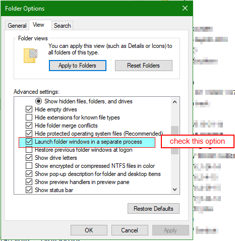

We had issues of Vault View (actually explorer.exe) crashing or closing “Randomly” from the day we started having users use PDM. Most users were used to have several to many File Explorer windows open throughout the day and using the Vault was no different, they would quickly have five or six if not more Vault Views open at a time. At some point in the storm of the first few weeks we discovered that the OS was killing explorer.exe when the GDI object usage hit 10k. Which will happen regularly if the user is opening and closing vault views all day and tends to have >=5 open at one time.
A really smart gentlemen showed us a setting in File Explorer Settings that can really change the way the Vault View behaves.
It is a bit like how web browsers will have a process for each tab that is open and pretty much solves all the problems by putting each new file explorer window in its own process which helps in at least two ways I’ve noticed.
  1. since all the explorer windows aren’t in one process we don’t hit GDI per process limit.
    2)closing the window will end that process and the OS can have those resources back, the next window that is opened starts a fresh process.
I have not noticed any downside to using the setting. I don’t understand why it’s not turned on by PDM client installation process, it really should be.

I’ve had a few machines (including mine) set this way for a couple months now. I don’t know much about how threads will behave when they are spawned from the same process vs threads in multiple instances of the same process so I don’t really have a guess as to what it could do to explorer.exe behavior. I trust they guy told showed this to me though, and he knows a lot about that stuff and PDM.
I have noticed that if I do something that would cause Explorer to hang and it was one of the secondary windows I can kill that process and it doesn’t close all of my other windows. Not a huge deal, but nice sometimes.

Looks like some update in Windows is causing this setting to no longer work. Now instead of having as many explorer.exe processes as I do windows open there are only two. Looks like there is one for desktop & taskbar stuff and a second that houses all the windows. I don’t know when it happened, but am now frequently seeing GDI counts for explorer.exe well above 5k on the PDM users.

Does anyone know if there happens to be a Windows OS setting to change this new behavior? This is affecting GDI limits in other than just Vault folders. I understand resources are resources whether they are consumed by one process or spread across several. The trick is if there’s a leak (PDM is not the only app that does this) if each window has it’s own process the “leaked” resource(s) can be reclaimed if the process is ended.
I think I would rather have a reg edit to change this behavior than reg edit to change the system wide GDI limit >10k.
