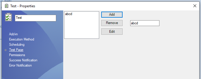

I tried intercepting the keypress events but the enter button doesn’t trigger the textbox keypress events before it closes the task setup. I’m thinking of converting this to a listbox with control buttons for adding or removing items from the list. It has the added benefit of having a sort property so I don’t need to sort the list every time I enter a new line.
Seems like a limitation. You can use an alternate approach by using a list and some buttons instead of a text box.
