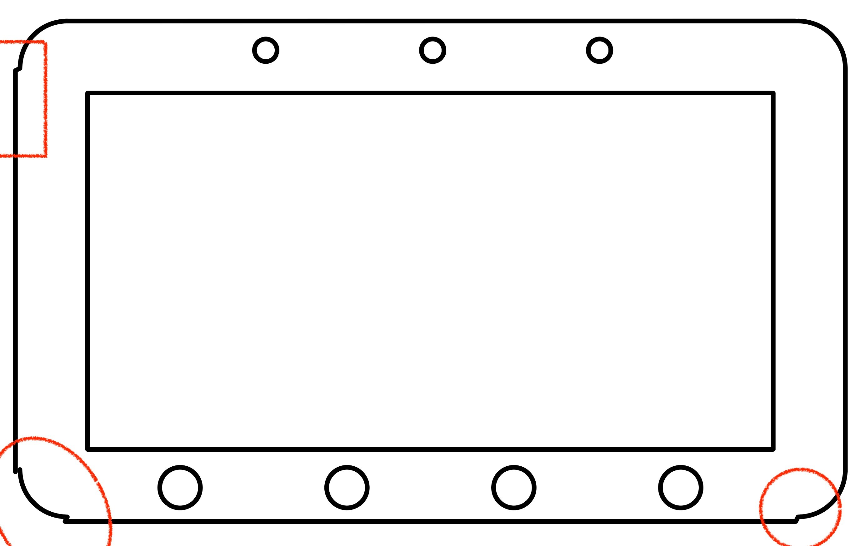

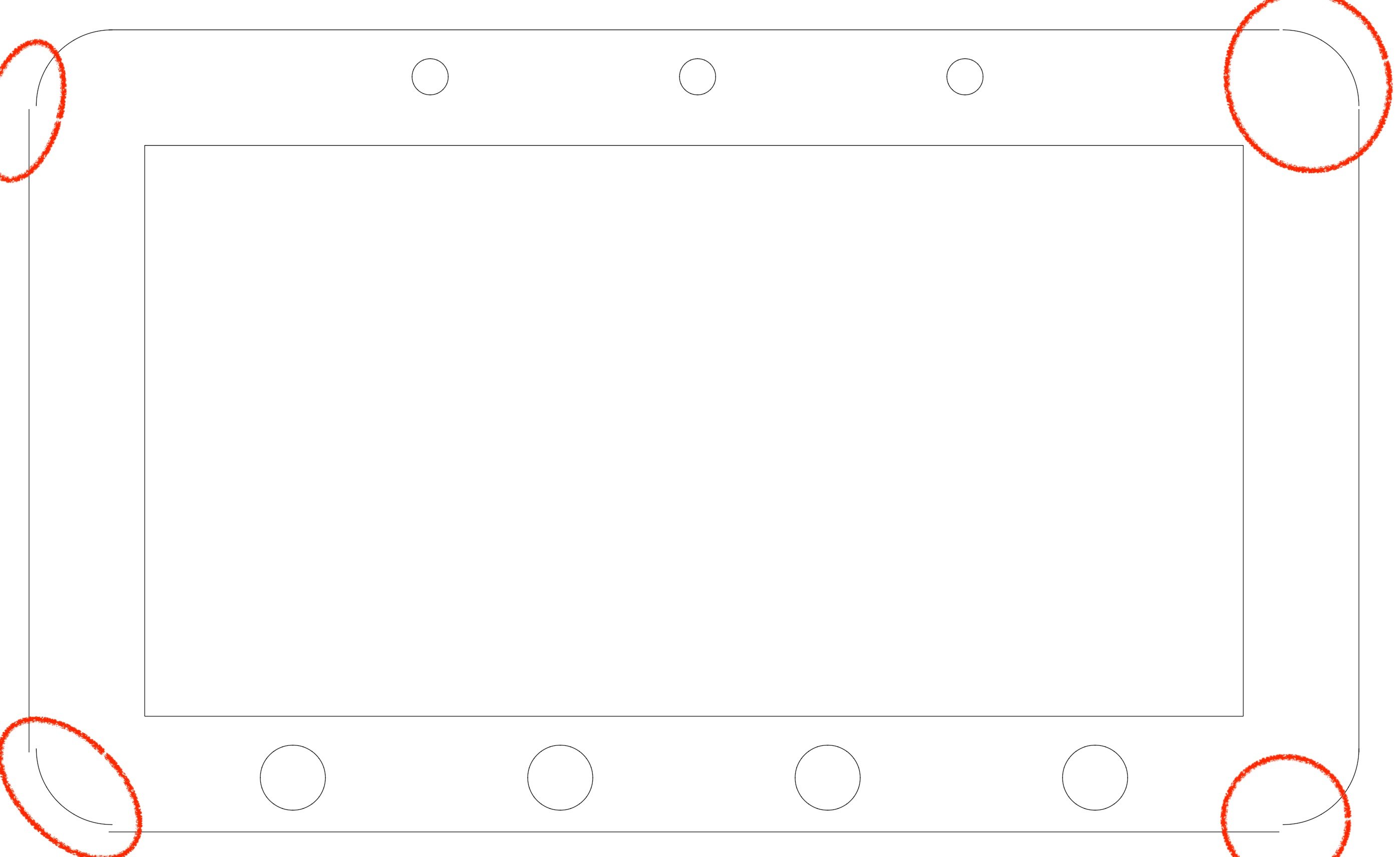

Good morning, I have been given PDF files produced by SPAC (Electrical CAD for Design) which present the problem indicated in the figure SPAC FIG-01.jpg.
the paths are not closed and are misaligned.
Has anyone had experiences of this type?

This could be one of a few things
  • The fillets (the curves) were not joined to the endpoints of the lines to begin with.
  • The second picture, it seems like these are still not joined, but it is at a lower resolution so it “hides” this issue. Which still is shoddy.
However, you need to know the radius of that curve to solve this, otherwise you are guessing.
Redo your outer rectangle to the correct dimensions.
For the fillet (curve), most better software has a command for this. It is called the “fillet” command. You selecting your two lines you wish to connect using “radius”, reading the command line. It should automatically do this for you.

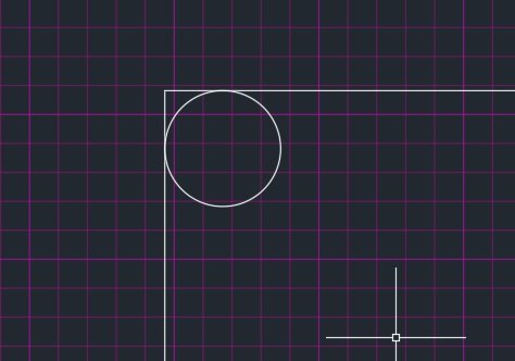

Another way of doing it is making a circle with the diameter and putting it tangent with the corner like so then trimming those corners.
