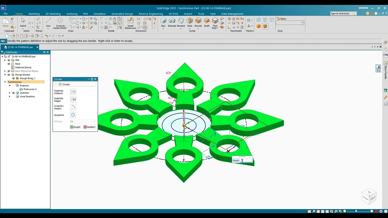

Can someone explain why im getting this error and failure to pattern?
First one is in sync and doing the pattern last, the second pattern first then extrusions last.
If its done all in ordered, i can pattern without issues.

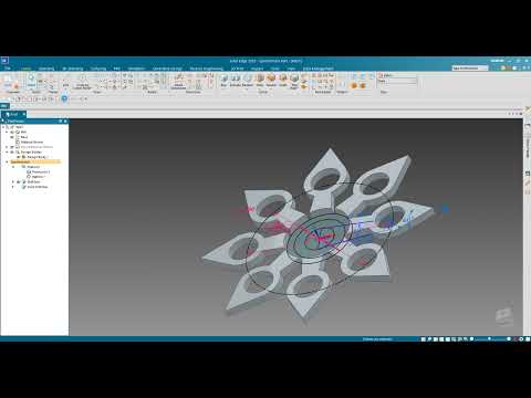

I tried the pattering again in synch, as long as i extrude and pattern the spade before the center round extrusions, the pattern works, if i extrude the center then pattern the spade it fails with same error.
I looked into this, and I think it’s a bug.
It works if the hole is not there, and it doesn’t matter if the hole was created along with the original extrusion or as a separate operation.
Also, it doesn’t seem to matter if the selection is by feature or by individual face selection.
It also works if the hole just creates a cut, but not an enclosed loop. For example if the hole were much bigger, so it just cut across the arm piece.
Anyway, I’d report this as a bug because it certainly should work.

I can’t seem to reproduce this. I’m using 2025 with Update 0006.
