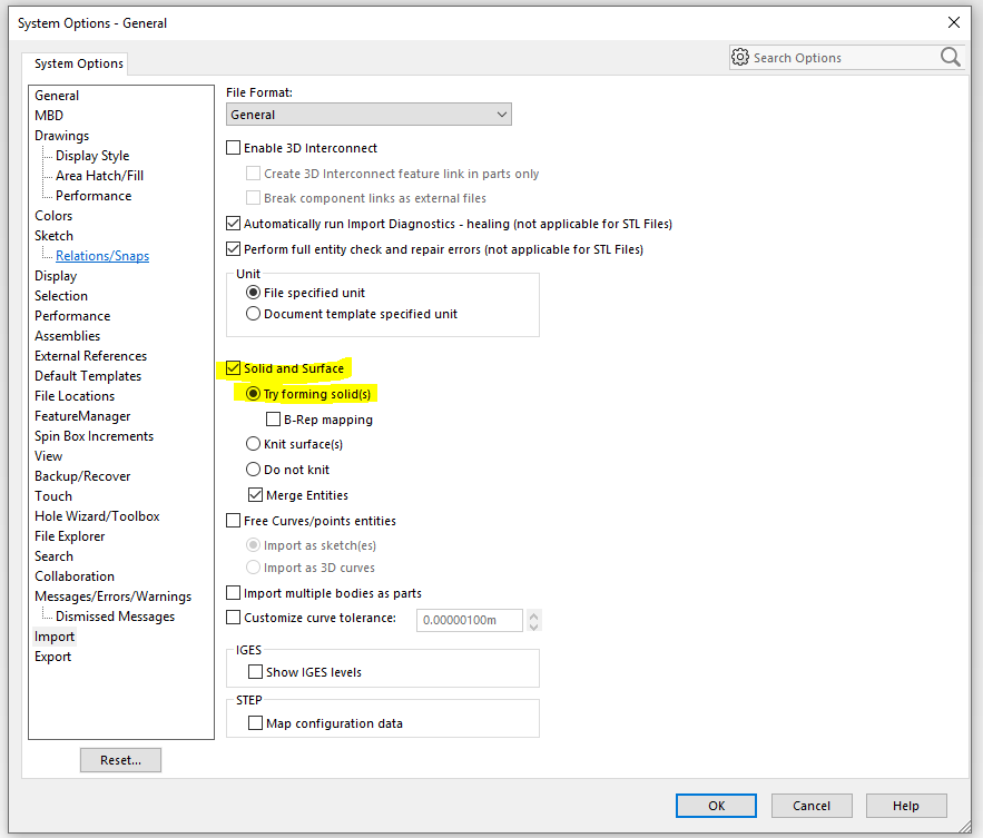

Just to make sure you aren’t spending time on something you may not need, are your import options set to create solids?
Yep.
It’s not every part, but a large (>50%) fraction.
