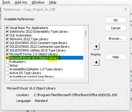

For the macro to work, it is necessary: a saved non-empty assembly must be opened. You must have Excel installed.
In the Microsoft Visual Basic editor, in the Tools - References menu, check the box: Microsoft Excel XX.0 Object Library

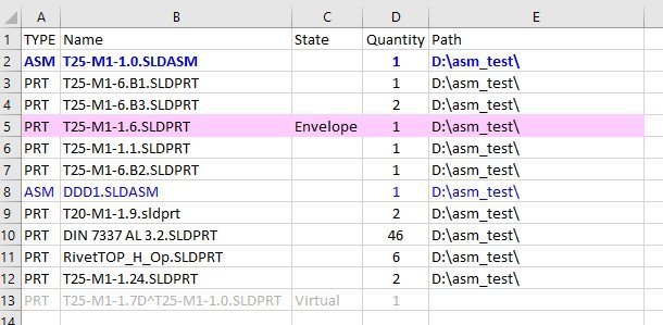

    SeeComponent xlWB 'In any case, we create an excel spreadsheet with a list of all the components.
                'And now we ask: the user wants to look at it. So the table exists in the background.
                Result = MsgBox("Display project table in Excel file?", vbOKCancel, "Information")

' The function generates an excel table with a list of all components based on the Dictionary with components.
Public Function SeeComponent(seelWB As Excel.Workbook)
With seelWB.Sheets(1) 'Assign column names.
    .Cells(1, 1) = "TYPE"
    .Cells(1, 2) = "Name"
    .Cells(1, 3) = "State"
    .Cells(1, 4) = "Quantity"
    .Cells(1, 5) = "Path"
    Dim ArrKeys As Variant
    ArrKeys = FILES_DIC.Keys
    For i = LBound(ArrKeys) To UBound(ArrKeys)
        Dim CompType As String 'Check for assembly part
        If InStr(1, CStr(ArrKeys(i)), ".SLDPRT") > 0 Or InStr(1, CStr(ArrKeys(i)), ".sldprt") > 0 Then
        CompType = "PRT"
        ElseIf InStr(1, CStr(ArrKeys(i)), ".SLDASM") > 0 Or InStr(1, CStr(ArrKeys(i)), ".sldasm") > 0 Then
        CompType = "ASM"
        Range(Cells(2 + i, 1), Cells(2 + i, 5)).Font.Color = vbBlue 'We paint all the assemblies blue
        If i = 0 Then Range(Cells(2 + i, 1), Cells(2 + i, 5)).Font.Bold = True 'We make the top assembly bold
        End If
        Dim waycomp As String
        waycomp = GetFileDir(FILES_DIC.Item(ArrKeys(i))(0))
        Dim isVirt As String
        isVirt = ""
        If CBool(FILES_DIC.Item(ArrKeys(i))(1)) = True Then
        isVirt = "Virtual"
        Range(Cells(2 + i, 1), Cells(2 + i, 5)).Font.Color = RGB(178, 178, 178) 'grey text - virtual
        waycomp = ""
        End If
        Dim isConv As String
        isConv = ""
        If CBool(FILES_DIC.Item(ArrKeys(i))(3)) = True Then
        isConv = "Envelope"
        Range(Cells(2 + i, 1), Cells(2 + i, 5)).Interior.Color = RGB(255, 204, 255) 'pink background envelope
        If Not IsSave_Convert_Files Then waycomp = ""
        End If
        'combinations of envelopes and simultaneously virtual
        Dim Sostojae As String
        If isVirt <> "" Then
            If isConv <> "" Then
               Sostojanie = isVirt & "\" & isConv
            Else
               Sostojanie = isVirt
            End If
        Else
               Sostojanie = isConv
            Else
               Sostojanie = ""
            End If
        End If
        .Cells(2 + i, 1) = CompType '"Part/assembly"
        .Cells(2 + i, 2) = ArrKeys(i) '"Name"
        .Cells(2 + i, 3) = Sostojanie '"Virtual"
        .Cells(2 + i, 4) = FILES_DIC.Item(ArrKeys(i))(2) '"Quantity"
        .Cells(2 + i, 5) = waycomp '"Path"
    Next i
    .Columns("A:E").AutoFit
    .Columns("D").HorizontalAlignment = xlCenter
End With
End Function
