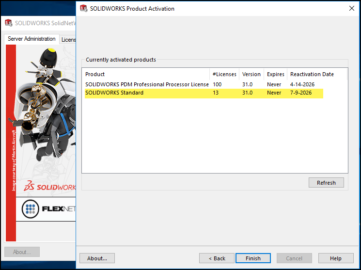

I tried adding the licenses that we dropped. Failed because the license server was upgraded to 2024 even though we are still on 2023, this was so we could test 2024.
I then went over to our PDM license server which was still running 2023 SNL server, it activated fine. says it never expires but still has an “Reactiviation date” so I guess you have to do that periodically.
@jcapriotti thank you for the test. As a perpetual license it works as expected.
sw imposed a new rule about reactivating the license at least once every 12 months.
we already do it for pdm,cad, simulation for both test and production snl and another stand alone machine running simulaton premium: annoying but manageable. now imagine to do it for 30+ stand alone pcs in the same situation…it would be crazy.
