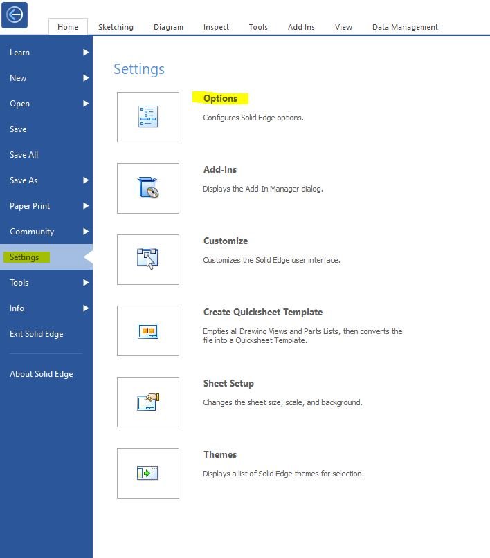

I had someone looking for an alternative to their current CAD system and they were thinking Solid Edge but were hesitant about the synchronous approach. I did ease their worries by letting them know that you can run Solid Edge in it’s original format by switching from synchronous to ordered in the options menu. This will run Solid Edge more closely to other CAD systems.
