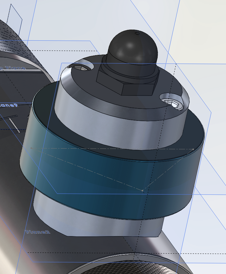

So, I have a cylindrical face and an existing 2D sketch defining points coincident with that cylindrical face.
When I use the hole wizard and go to place my holes, it is not working. I figure its an order of operations or a small technical issues but I haven’t been able to sort it out yet.
Here’s what I’m doing:
1.Start Hole Wizard
2. Configure Hole
3. Select the appropriate body (Multi-Body Part)
3. Change to Positions
4. Select Cylindrical Face
5. Try to selct sketch points = FAILURE
Thoughts?
Error Message: Points to locate holes are not valid. They may not be constrained or may be located on edges or vertices
For some reason, it doesn’t want to let you make your hole locations coincident from within the hole wizard. You can, however, just put some hole locations on the surface, then exit the hole wizard, and then go back into the 3d sketch and make the points coincident.
