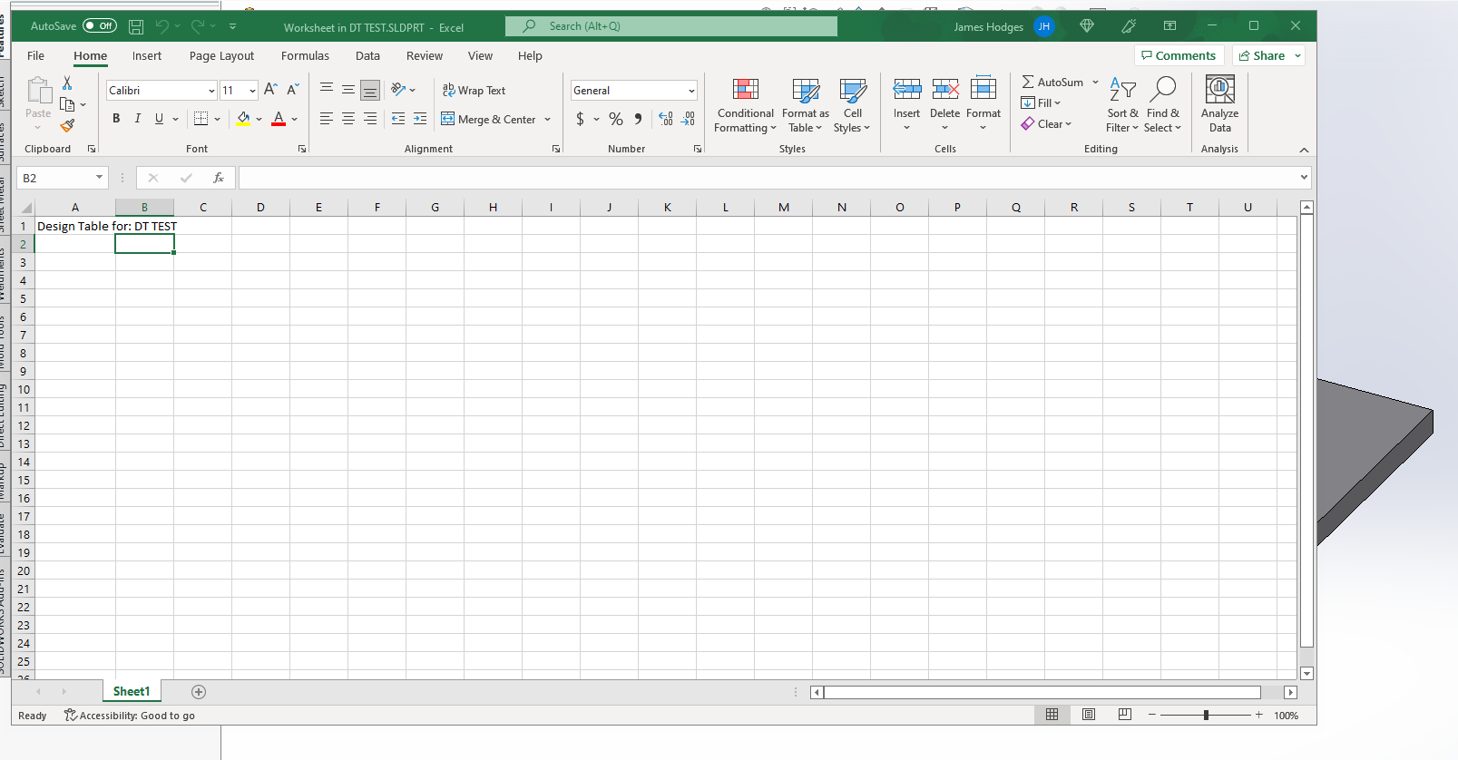

As of this morning Excel still does not work for me. i am on Solid Works 2022 sp5. I created a temp part to test, went to insert/tables/design table and started a new design table. Excel did pop up and then it just sits there with the circle spinning. it finally returned an error (failed to launch server application).. from everything that i have found Solidworks does not support office 365 at this time. Office 365 does not include the .new programmability support function which is needed to work with Solidworks. all of the information that i have found, including from our VAR, says that we will have to delete Office 365 and install a standalone version of Excel. i am hopping someone else has had this problem and found a way to get it to work. i have found a workaround that we may have to use for now, but that only helps with design tables and it sometimes does not work. we also use Excel to work with our tool box. with Office 365 tool box will not import any new information from Excel into the tool box database.

It seems to work for me. Have you checked to make sure that you’re running 64-bit office apps? You can click on File → Account → About Excel to verify this. The top line of the About window will state either 32 or 64 bit after the build version.
Yes it is 64 bit.
any idea what server application it failed to launch?

i am using SW2022 sp5. it still does not work when opening in an excel window. i have not tested opening in the sw window yet. if that works it will work fine for design tables. however it does not fix the export/import function in tool box. What i have found is the Office 365 does not include the .net programmability support feature required for the Solidworks configuration import/export function to work properly. according to Microsoft the .net programmability support in only included in the offline (msi) office installation packages. the only current solution is to uninstall Office365, download an offline (msi), may have to be purchased, installer for your Microsoft office package and use that instead. Currently my company does not wish to do that, at this time. we are going to wait until someone finds a way to get Office 365 to work with solid works.
