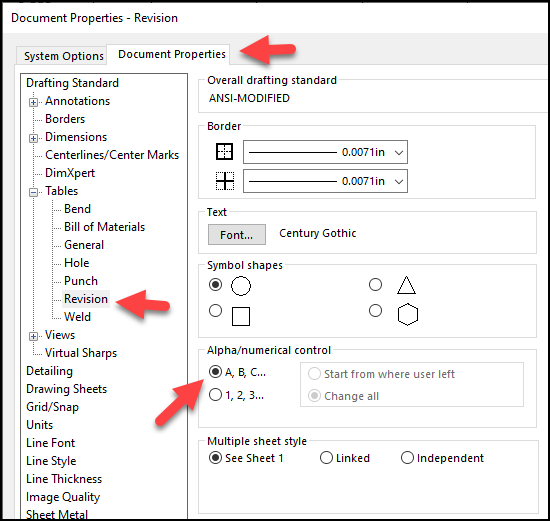

It’ more than likely the revision table. In your SolidWorks settings, you have this settings for drawings that defines the custom property for revision:
And this for revision table:
If you manually add a row to the rev table, it will push the next revision letter to the “Revision” custom property. “Custom” is mapped to the @ tab in PDM so it’s probably overwriting it.

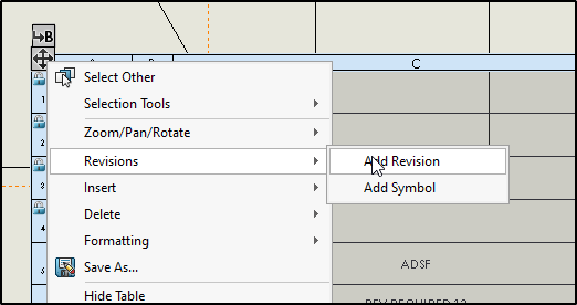

yep. my PC puts the ‘~’ character in the table revision column but does not change custom property. I’ll check with others.
Maybe a bug there…or maybe someone had their PDM add-in turned off and was able to “Revise” the table?
It’s messy. feels like another room in the house of cards.

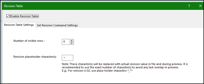

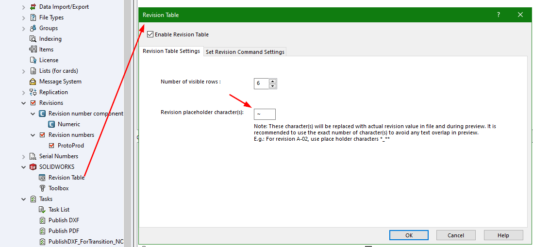

If the file is not saved into the vault yet (new file) but I’m very much connected to PDM, then I can Add Revision over and over and get A, B, C etc. If the file has been checked in then I can only Add Revision once and it gives me the ‘~’ character (which I think is somewhere in PDM but I don’t recall where right now.)
Edit: found where the ‘~’ is comming from:

Still watching this and have a few pop up now and then. We have confirmed and replicated that the process of deleting and adding a row in the revision table (automated through PDM) will cause SW to set the revision custom property to the next letter. The letter scheme is zero based, in that if the file is at rev 00 and the rev table is edited the custom property is set to A. If the file is released at rev 06 and transitioned to WIP then the rev table is manually edited for whatever reason. A row is deleted and new one added the letter will be H which corresponds to the next rev of 7.
It is repeatable for a file that exhibits the behavior, but not all files will do it. I believe at some point along the bumpy beginning phases of our venture into PDM and Solidworks there was a time where some setting caused files created during that time to have this problem. We cannot find any new files that have this problem so we’re fairly certain it was a problem at one time that was corrected before this symptom showed up or before we correlated it. I don’t know that there is a fix aside from redoing the affected drawing from scratch when one is found. The work around is in the rare case that the rev table has rows added or removed manually the Admin must fix the revision.

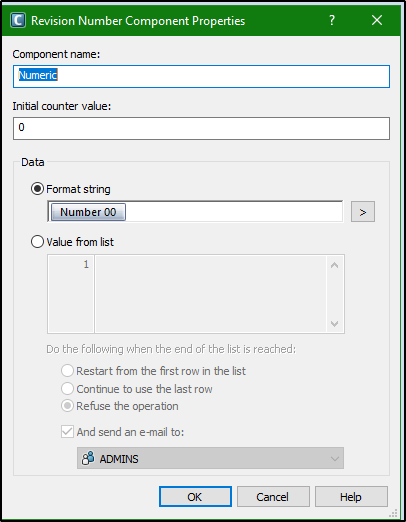

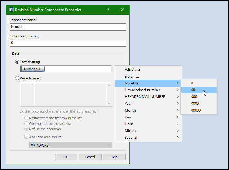

How did you add a leading 0 there? We will be changing our revision system this year & a leading 0 gave us problems.
Can you delete the rev table, copy all the contents, re-insert & just add a new line to fix the problem? You can also re-set the document properties to your gusto at the same time.
We i.e. do that to fix our PDM copy tree’d/branched drawings that way…
Once the rev number is copied to the data card variable (using transition action set variable = %nextrevision% ) it’s just dumb text, nothing special. From there everything uses the data card variable or the mapped custom file property.
The “Revision Number Component Properties” in the Admin Tool is where we set the rev number format.
