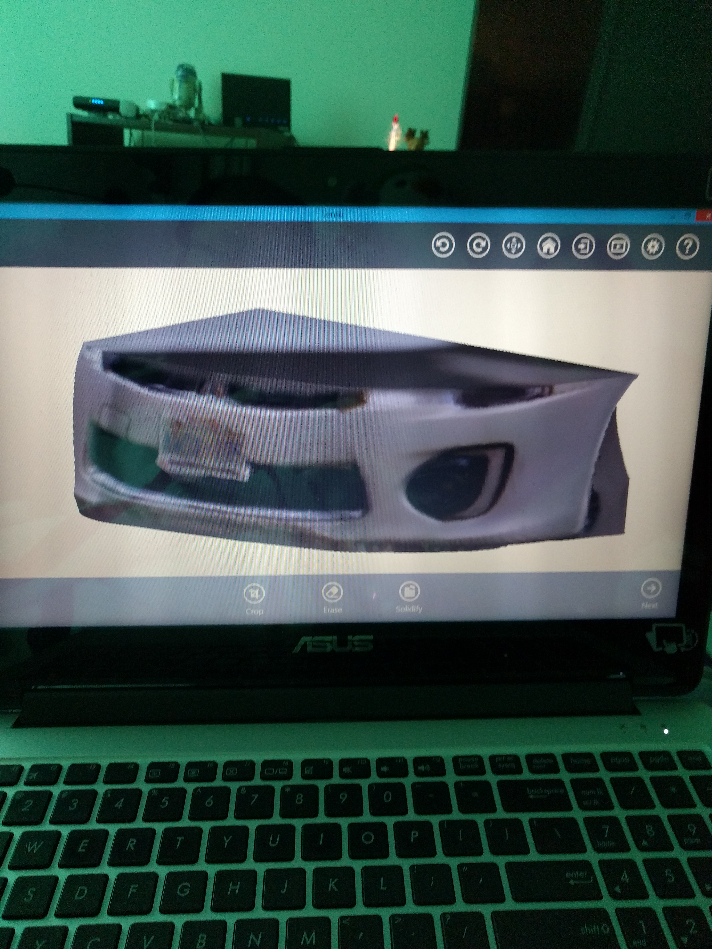

https://www.amazon.ca/3D-Systems-Sense-Scanner/dp/B00HLJFMMO
Got it used for $200.
It’s not easy to get good scan.
That looks like a really good scanning there though. The bumper surface seems “flat” as it should be,. We tried a few scanners, maybe we didn’t know how to use them properly but the triangulating on it was just awful. Flat surfaces would triangulate all over the place and the files were like 600mb if I recall for a rather small component scanned (12"x6"X6")
It doesn’t look flat up close.

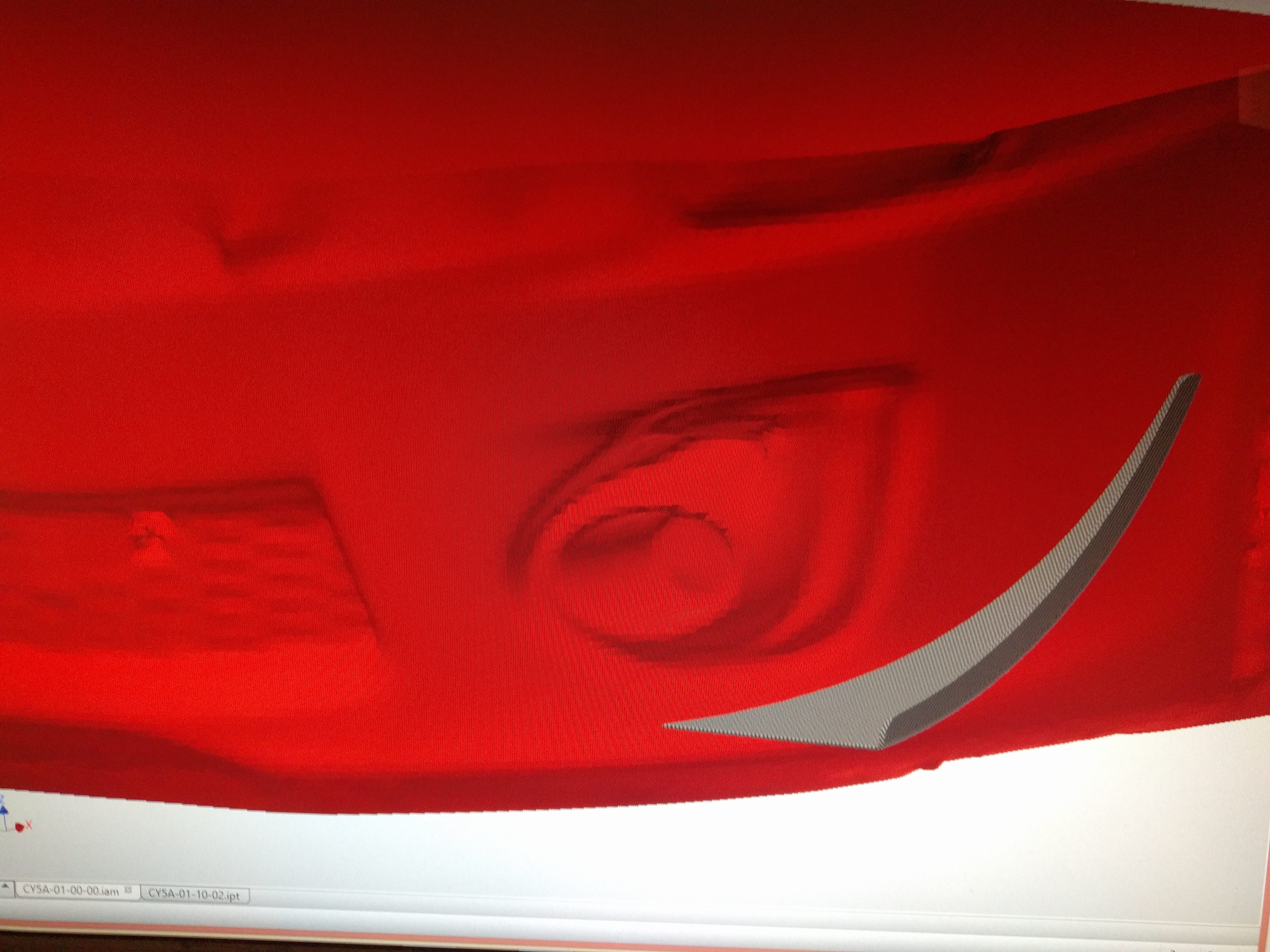

The scan software can smooth them.
It can also fill it up to make a solid.
That’s what I did and used it to cut the canard.
Whatever different will be take up by mounting tape ![]()
I think that’s the only good scan I got.
Tried to scan side mirror, rear bumper and spoiler and they didn’t come out good.
The scanner keep losing tracking and throw surface all over the place.
