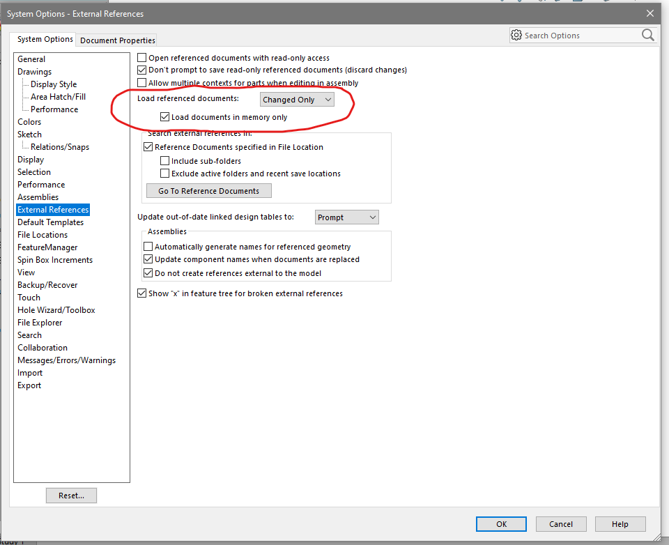

What do you have set here?:
That box wasn’t checked, but I tried de-selecting it and it didn’t make any difference.
