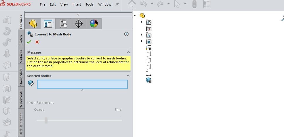

I upgraded to v22 SP1.0 not long ago, and somehow in the process managed to bugger up all my screen colors.
I’ve seen all the stuff about scenes and such, but the text in the “auxiliary” selection is the same as the background…
Is there a way to reset all the screen colors to original?
thanks!
chris
More specifically, how do I make the text in the flyout feature manager tree visible?

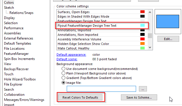

I would start by resetting to factory settings. That’s in the bottom left corner of the Systems Options window.
Dwight
Yep. Done that. Even went so far as to delete the user config from the registry.
No soap.
Thanks
I am assuming you’ve clicked to reset colors to defaults since it’s already mentioned. Is your flyout feature tree color set to white right now? See the image below for which setting in the colors menu to change if it needs to be darker. (I’m using 2021 but am assuming it’s still the same)
