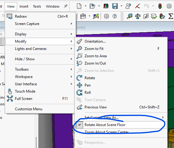

Looks like the view “lock” when that face line up “flat” to the screen.
Have you looked at the mouse driver?
they symbol
means that it is going to try and rotate about an axis.
Un-check this box.
Bless you. Thanks!
