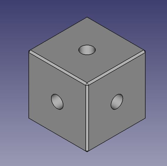

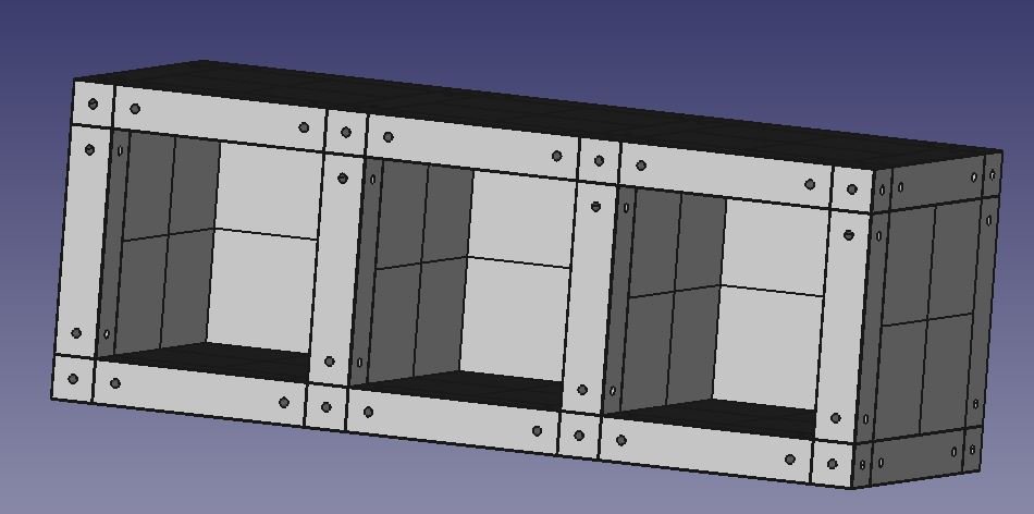

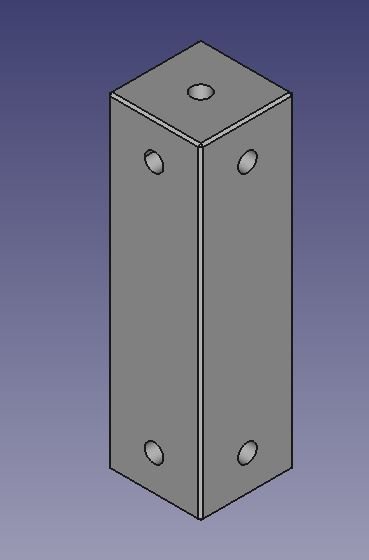

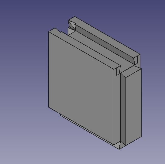

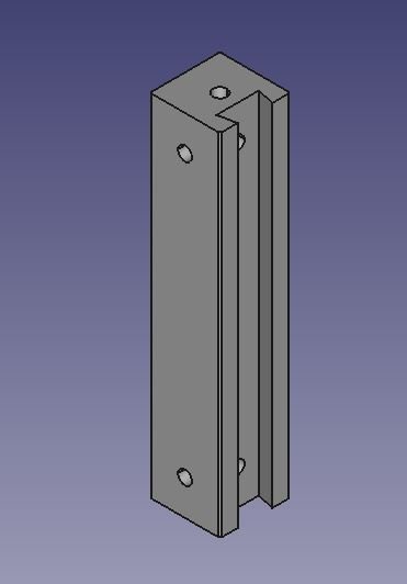

I already started to construct some basic elements and combine them to different kinds of furniture (see the attached images and pdfs).
In my current design I use dovetail joints to join the plates with each other and with the rods. I don’t know yet how to join the rods with each other (I used holes in the rods to symbolyze the areas where they can be joined).
Currently I have 5 different elements: a plate with dovetail joint, 2 types of rods with dovetail joints, one rod withouth dovetail joint and a cube without dovetail joint.

I think you could use pins as the simplest auxiliary structure to connect everything, although they are very susceptible to sheer stress.

With wood, depends on what kind of wood. When I helped my dad make furniture for arts and craft shows, pine is the cheapest, lightest and easiest to work with at the expense of durability and the fact you have to pay very close attention to knots and grain. You also hopefully have access to the equipment that allows you to put dovetails and grooves in easily. oak is sturdy and lasts forever, but very hard to work with.
