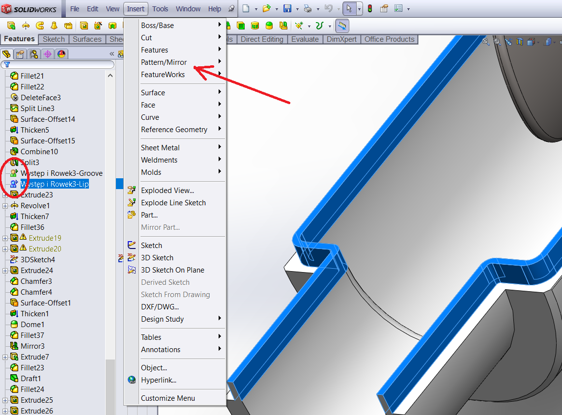

I was forced to change the computer and therefore the operating system from WIN7 to WIN10. Well, after installing SW 2012, a problem appeared - there was no FIXING OPERATIONS command in the INSERT menu. Has anyone had something similar and maybe solved it? It is also not possible to add icons with commands to toolbars. There is also no REALVIEW option, but I don’t need it to be happy :wink:

Hey Paul, no, I mean fastening operations, as in the illustration below, normally there is a Fastners Operation submenu (eg grove/lip), but I don’t have it. Also you can’t add commands to the toolbar! Yes Alex, I set the compatibility mode to Win7 but it didn’t help. But I have more information. I made this feature on an old computer and when I opened it on a new installation in Win10, a strange icon appeared, which suggests that there is something wrong with the permissions/license? - I have Professional

\No, this is not macro or add. This is standard SW command - Groove/Lip

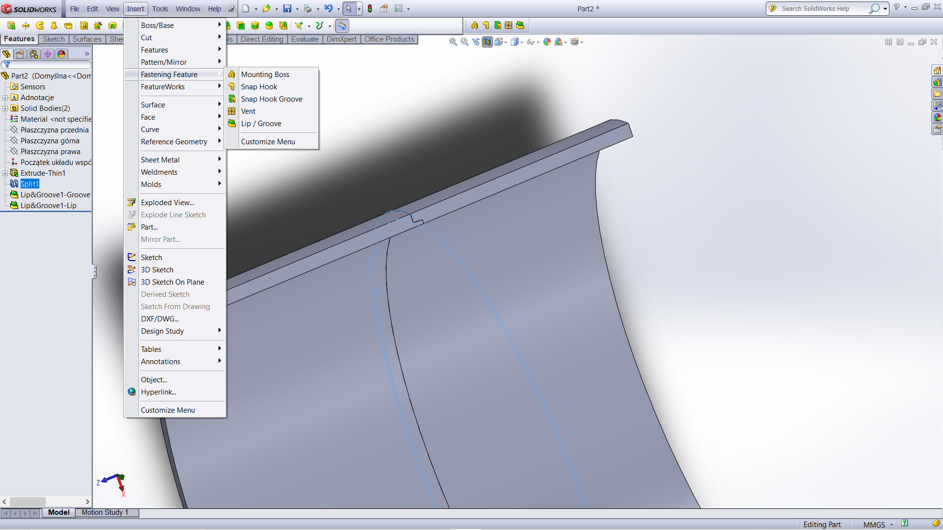

https://www.youtube.com/watch?v=-geQYhRaQD4

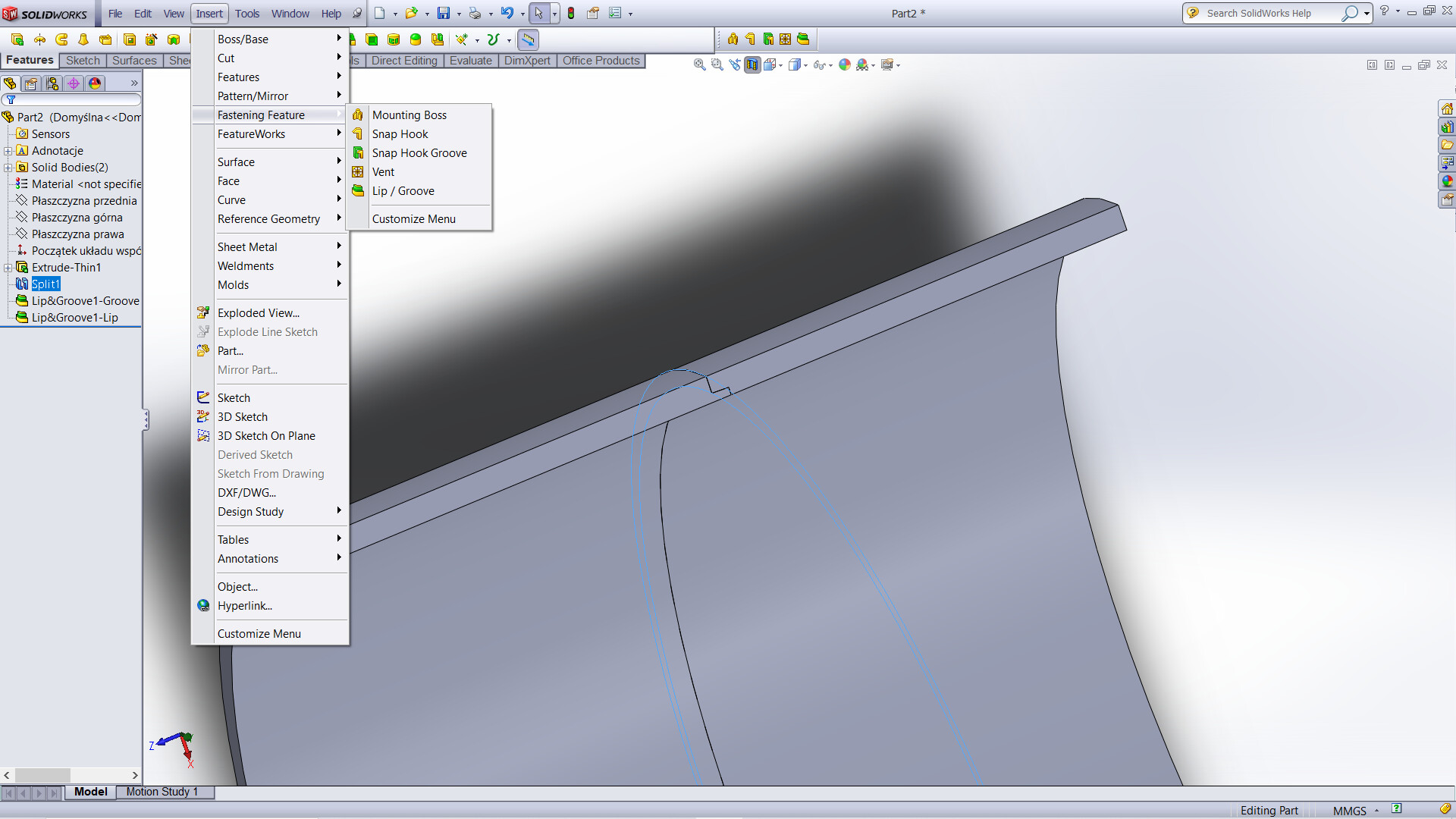

Can you see the toolbar?
Yoouuuuu!!!
You’re great!!! ><
I googled for two days but forgot about YouTube! o[
One time more. THANK YOU!!!
Youuuu!
You are great!!!
Submenu back, toolbar back and… work! ><

No, I just installed it by disabling the antivirus before installation. When I noticed that something wasn’t working, I uninstalled it with the registry cleaning option and installed it again. It didn’t help. My VAR didn’t help either. Only the changes from your link gave the result. Thanks again.
