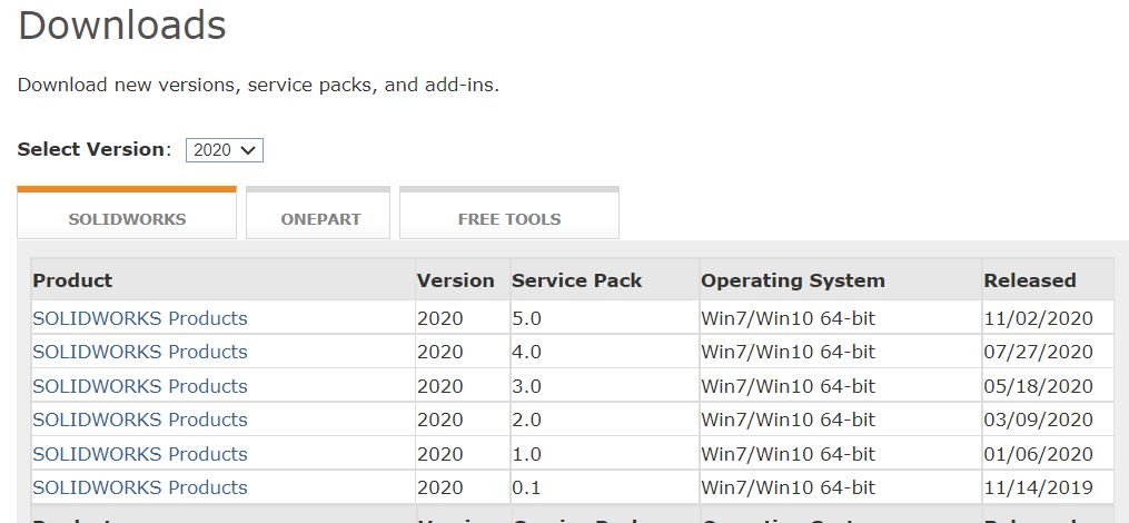

well even the SW download site doesn’t have SP0
Because it’s so bad they replaced it with 0.1
LOL
Now I don’t know if 0.1 will work the license.
