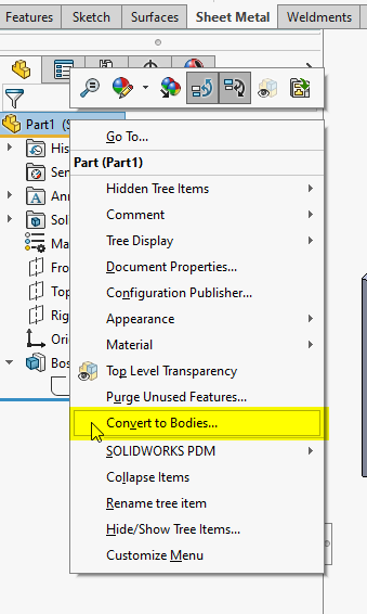

Does anyone know if there is a method in the API for the Convert to Body function?
I have recorded the steps, but it looks like the function is not logged.
SPR 880569: Need a new API method for function Convert to bodies.

I don’t think this will work, but I’ll post it just in case.
You can make a copy of the body or bodies
IBody2.Copy2
then create an Imported Feature from this body in a new part
IPartDoc.CreateFeatureFromBody3
But this isn’t exactly the same as Convert to Bodies, which preserves geometry links to other files.
