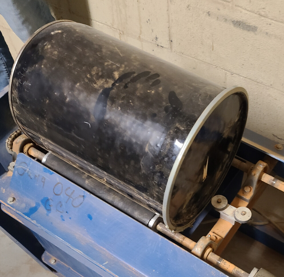

Long story is, our materials labs have these machines for soil preparation that rotate steel drums containing metal rods to pulverize soil. Problem is that they can’t get drums in thick enough gauge steel anymore.
So, does anyone know a shop that would be interested in making 18 gauge drums (~ 5 gallons)?
Here’s a picture:
What’s particularly troublesome is that the lid is complicated because you may not be able to use a band with a bolt…if you did, it would have to face away from the bottom, because it would hit the roller:
Here are the dimensions:

..maybe 10"-12" steel pipe/tube cut to ~16" length and weld on rings for your clamp on lid/plates?
Yeah, thought of that. It would work, but would be too heavy for both the people who have to maneuver it onto the rotating machine, and maybe even for the machine.
I tried searching for tubing instead of pipe, and turned up a place that makes 14 gauge. That makes the container ~20lbs 18lbs (smaller diameter, had to change that) vs ~15lbs for 18 gauge. That may be doable.
