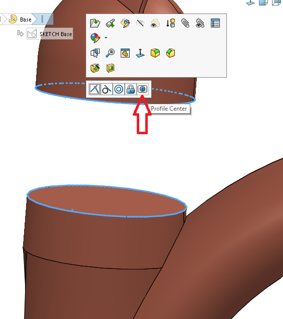

In any case, I’d suggest a different workflow, and use a Profile Center mate instead. That will accomplish your goal without the need for added reference geometry, and it can be set to allow rotation, or you can lock it.

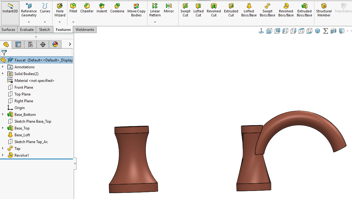

By the way, I took a look at your Faucet part. Maybe you’re just learning different techniques, but if not I wanted to mention that you could accomplish your Base Bottom, Base Top, and Base Loft all with a single Revolve. See below. I put my sketch off to the side of your model to illustrate what I mean. I didn’t take the time to fully define the sketch with relations and dimensions, so it’s not exactly the same as yours, but you should get the idea.
