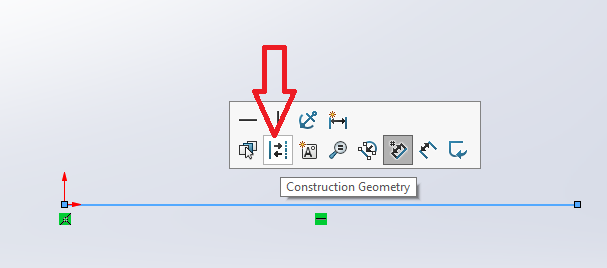

I’m about halfway through it. He has some good stuff, but there’s one or two things he does the hard way. Like using the Trim tool to convert a line to construction. Why not just click on the line to get the relations toolbar and select the “Construction Geometry” icon?

Yes, if you have multiple lines, and they can’t be easily selected with a click and drag box selection, I can see where converting them to construction with the Trim tool might be faster. Otherwise I’m convinced the relation pop-up is faster.
To be honest, I’m not saying there isn’t one, but I’m having trouble thinking of a situation where I’d need to convert multiple lines to construction.
