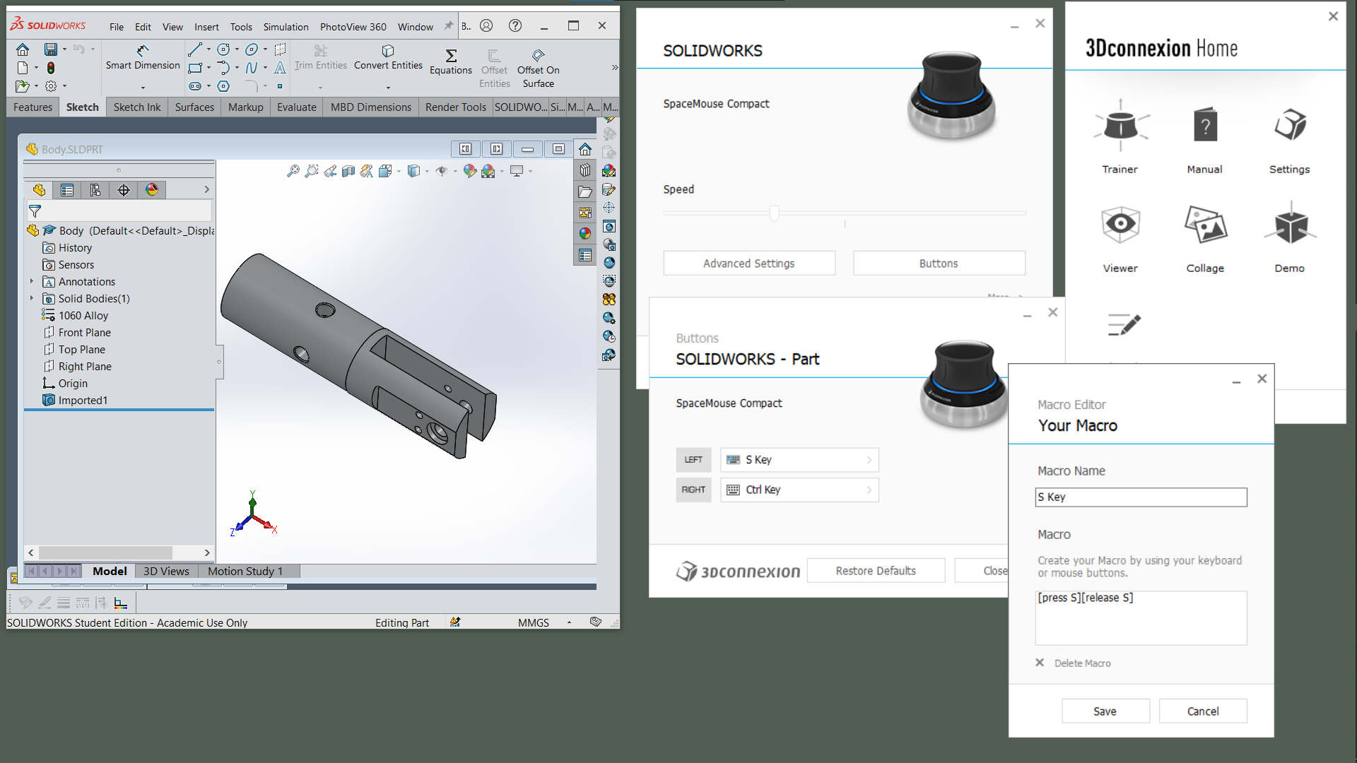

I have the 2-button wired compact version. Probably not as stable-on-the-table as the more expensive version, but I solved that (and saved myself €100) by sticking it down with a few balls of blu-tack.
My 2 buttons are assigned as LEFT = S Key Shortcut Menu . . . and RIGHT = CTRL KEY.
This, combined with a cheap-generic vertical mouse solved all my RSI issues. Wouldn’t be able to do CAD without them.
How did you setup the left button for the S key shortcut?
Had to go back and check. Had forgotten, it was so long ago [see screenshot attached]. First thing is to make sure you have a SolidWorks ‘Part’ file open, then it was just recording a macro (yes, you can do that) containing just a single press of the ‘s’ key.
You might also consider changing the right button to ‘Add Mate’ when an assembly file is running.
You don’t have to make a macro you can simply type the shortcut in the box.
Cool. That might have been how I did it originally. That method seems to create the macro for you automatically, but it is still a macro, just auto-generated.
