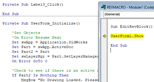

The Debug highlights UserForm1.Show. This is the same command for both macros.

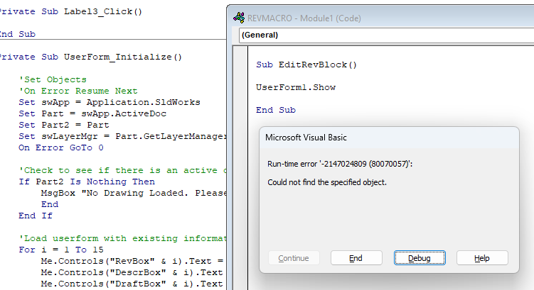

  2. Comment out this line, and you may get better error information:
On Error Resume Next
That line basically says: “If something goes wrong, don’t say anything, just keep going.”
Thanks for the reply. Continues to not function.

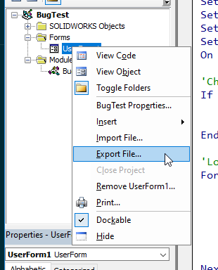

Right click the UserForm form in the VBA editor:
to export it and then upload the .frm file here.
Here is the file.
UserForm1.frm (8.1 KB)
Looks like you will need to upload the entire macro file. SOLIDWORKS embeds the form UI data in the .swp file instead of a separate .frx file like you see with Excel.

The code fails here:
'Load checkboxes
    For i = 8 To 15
        Set swLayer = swLayerMgr.GetLayer("REVLINE" & i)
        If swLayer.Visible = True Then Me.Controls("RevCheck" & i) = True
    Next
Assuming that layers REVLINE8 through REVLINE15 exist and are visible, it is trying to set the state of checkboxes named RevCheck8 through RevCheck15, but those controls do not exist on your user form.
Why would the macro work on some drawings and not others? Could it have something to do with the drawings themselves? All drawings have those layers. They are not visible until they are turned on thru the macro. That statement is the same in the old macro and it works fine. It seems it only wants to work on some drawings and not others.
Thanks for pointing me in right direction, think I got it. The drawings that it does not work on has REVLINE8 visible. The drawings that it works on has REVLINE8 not visible. It must not like that. When REVLINE8 is set to be not visible it appears to work.
Yes. Because it is trying to change a control that doesn’t exist. It looks like at some point there were more checkboxes for those layers.
There were more check boxes. Where its running into problems is when the lines 8 and above are already filled out. Thanks again for your insight, now I have a clue to what changes are needed.
