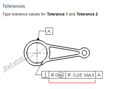

Can you be more specific as to what you’re referring to as “Tolerance 1” and “Tolerance 2”? It’s a bit unclear from the information you’ve given.
If it’s referring to the standard +/- tolerance on the actual dimension, you can obtain that through IDimension.Tolerance. If it’s referring to something else, please point us in the right direction.
See example below.
Tolerance 1 is diameter 0 @ MMC
Tolerance 2 is dia 0.05 max

The tolerance values are in the array returned from GetFrameValues. You have to use this along with GetFrameDiameterSymbols and GetFrameSymbols3 to get the full picture.
A symbol like this:
outputs a set of data like this:
Frame 1 start
	================== Has Diameter Symbol =================
	True
	True
	================== Frame Symbols =================
	<GTOL-PERP>
	<MOD-MMC>
	<MOD-LMC>
	<MOD-LMC>
	<MOD-MMC>
	<MOD-LMC>
	================== Frame Values =================
	0
	.05 MAX
	A<MOD-LMC>
	B<MOD-MMC>
	C<MOD-LMC>
Frame 1 end
The LMC/MMC information associated with the datums appears in both the results from GetFrameSymbols3 and GetFrameValues. The whole IGtol API seems like it was programmed by comittee.
I hadn’t noticed GetFrameDiameterSymbols…nice!
Where I think the trouble lies is determining where the modifiers are in the frame (specifically, tolerance 1 and tolerance 2). I know I was overthinking it, though.
