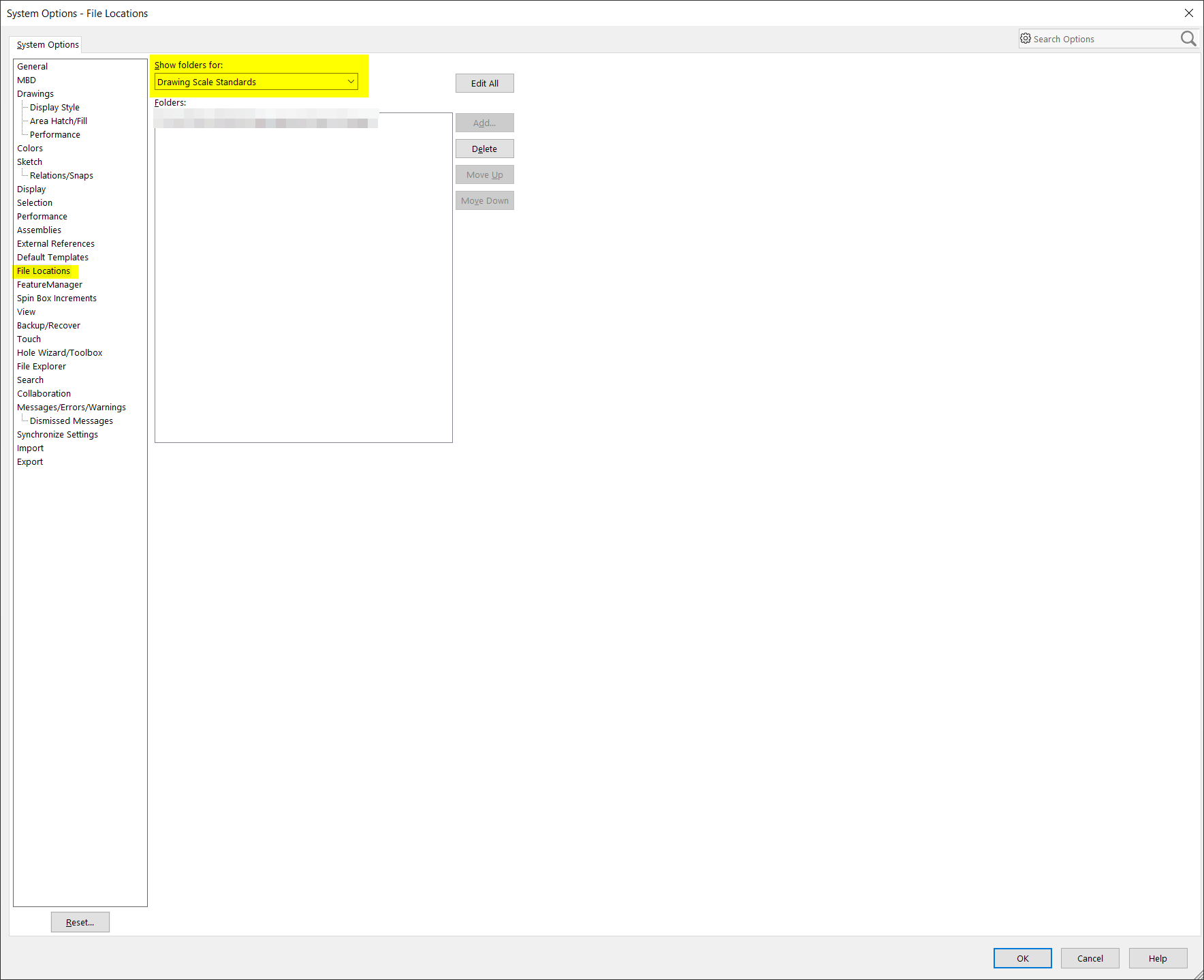

Be aware that these macros will update your drawing formats.
Further investigation lead me to think that this behavior appears only if the original scale of the sheet is different from the ones presents in the file specified here:
So I modified the file adding all the drawing scales we needed, and placed it in a share folder for all our users to have it.
I hope it helps.
