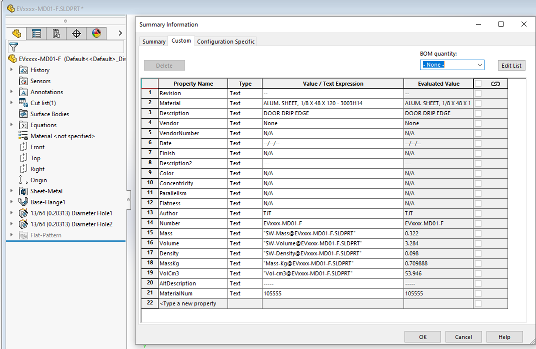

For instance this part is EVxxxx-MD01-F, the number field is the same.
This is a part in my base assembly EVxxxx-MD01, I will do a pack-and-go and renanme the assembly to EV1458-MD01 and the part will become EV1458-MD01-F. I would like to run the macro on the new assembly and change all the EVxxxx out on all custom properties to now be EV1458. Has anyone done something like this? And is it even possible to change custom properties on parts in an assembly when running the macro on the assembly level?

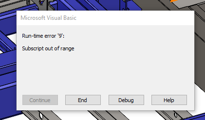

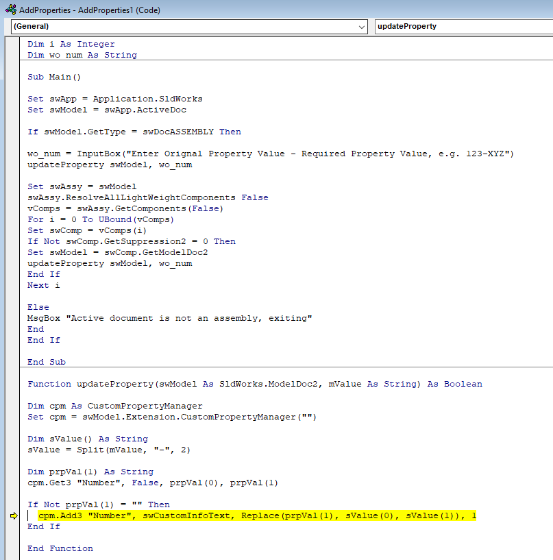

I have used this macro every now and then for a couple years since it was created. It was working, but now I get an error when I go to run it.
This is what it shows me in the debug
Any ideas why it won’t work anymore?
